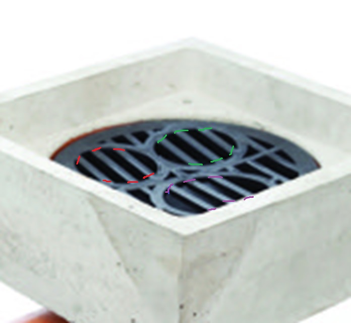

Standard grate grids have marked cutouts already there for common pipe sizes...
The smaller red and green ones are for waste pipes, the larger purple one fits a round downpipe. Use a square to round adaptor if necessary.
I used a stack of couplers to extend the existing pipe that previously had a shoe. There's enough slack to squeeze them together, slide one out then remove the gully lid if ever needed.

Building Regs, Part H, section 1.13 'A branch pipe discharging to a gully should terminate between the grating or sealing plate and the top of the water seal.' This was done to allow the full force of the discharge to cleanse the Gully, and prevent build up of stinking residue on top of the grid, which often eventually blocked the grid.
Not the most pleasant of tasks, cleaning years worth of kitchen waste, soap and hair from a blocked gully grid.
If a bit of thought is put into the waste pipework installation, it's usually possible to allow enough movement to permit the grid to be lifted out, but the only time that should really need to be done is if the gully is blocked. Proper disposal of cooking oils and fats should negate the worst of that issue anyway. Metal grids can soon be replaced with a plastic equivalent to allow the grid to be cut to accept the pipework.
Rainwater is often better connected via the back inlet, this allows easy removal of the grid for cleaning when needed, but if going to a soakaway or surface water sewer, there is no need for a trap, so a Rainwater gully, designed to catch and collect detritus, is a better option in this instance.
Regarding the original question, no, that is not acceptable. Splashback from discharges is going to make a mess everywhere, and will likely cause damage and/or damp issues in the wall behind. Both pipes need to be extended to discharge below the grid to avoid unsanitary/damp issues. Get the installer back to sort it properly!
