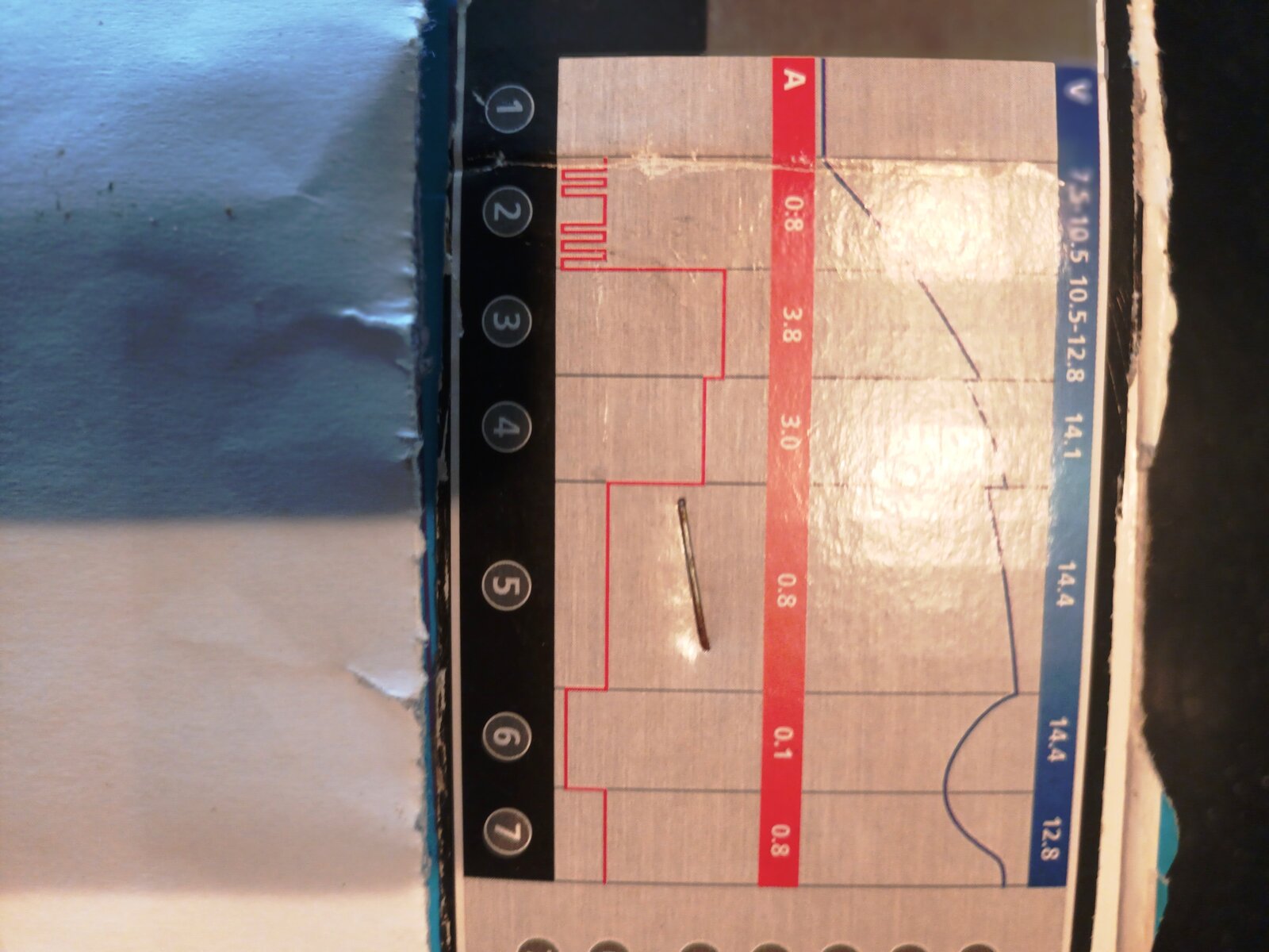

I have a LIdl smart charger, a Ultimate Speed ULGD3.8A which I have never used on my own cars (VWs) but occasionally recharge a old house alarm 7.5AH battery that I use occasionally for various small requirements around the house, after the initial charge it settles down and maintains a trickle charge seemingly indefinitely so I unlug it after 6 hours or so. I have used it occasionally on a few neighbours batteries, one, a 110AH in a 2L diesel Opel which was completely flattened by a cabin light being left on for over a week. As above, these chargers will not charge if the terminal volts are ~ < 7.5V so I had to connect a bit of cable between my car and his and after that the charger started charging, I removed the cable after 45 minutes or so and the charger fully restored his battery after ~ 24 hours and is still fine nearly 5 years later.
Below is the chart that was on the side of the box.
1 Reverse Polarity Protectionand Trickle charging and diagnosis.
2 Recharge/desulphation.
3 Start of charging with a high current strength.
4 Charging up to 80%.
5 Absorption charging up to 100%.
6 Trickle charging and monitoring.
7 Demand recharging.
