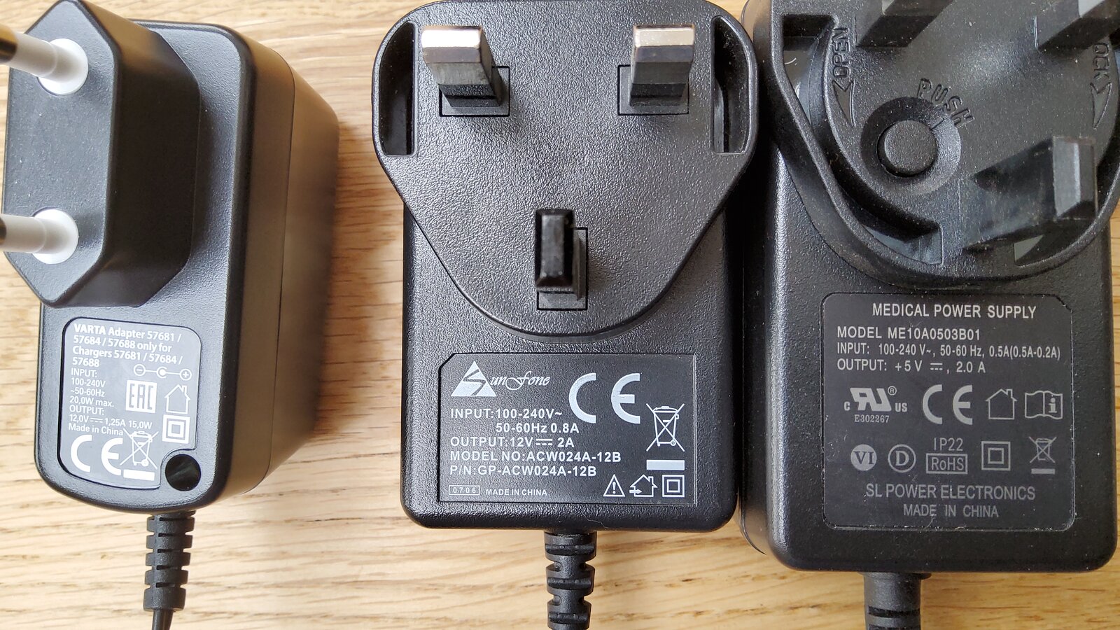

But it has an EU 2 pin plug on it and no adapter. How annoying.
Which of the details on the plug are important? I have 2 random power supplies from other gadgets. Will they do? Or do the figures have to match exactly?
On the photo the supplied 2 pin plug is on the left.

Quite a few details are important
The middle one - showing output 12V DC which is the output you need @2A which is more than the 1.25A - which is good
Also the Input needs to be in the range of your supply and frequency
BUT
The polarity is important , on your plug, you see the middle pin is +ve - thats important
BUT the middle one does not have that, so maybe -ve middle and not suitable
The image on right is 5V O/P DC - so no good
Thank you everyone. I think i should send it back then. It was from Amazon (not marketplace) so at least returning it is easy, though annoying.
