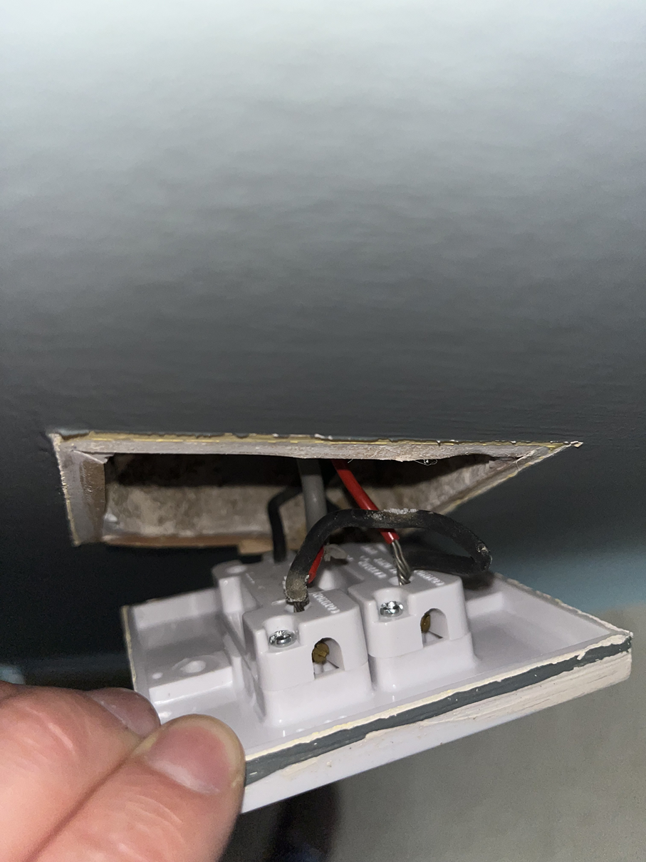

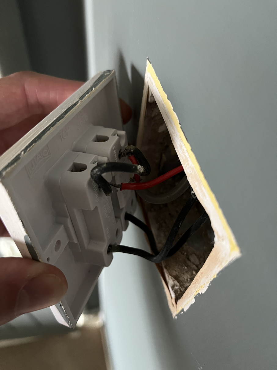

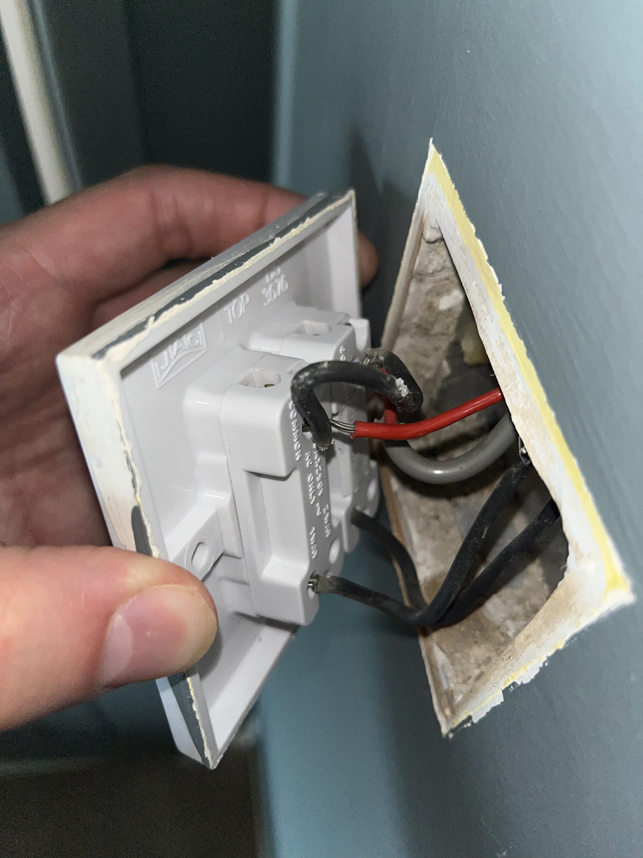

We're replacing the light switches and plug sockets in our living room, the plug sockets were easy enough but I was looking for some guidance with the light switch.
The old switch has 4 terminals (see photo)
The new switch has 6 terminals + earth (see photo)
I'm guessing the common wires go into COM1 and COM2?
I'm just a bit unclear about L22 L21 L12 L11 - what do these mean?
I assume I should also be connecting the earth terminal to the metal back box?

Red wires to COM 1 and COM 2. Get a short bit of 1.5mm wire and interlink from COM 1 and COM 2 on the new switch.
The wires at the bottom - One in L11 and the other in L21.
Yes.
The use of either L11 or L12 will change if the switch is up or down for on, but either will work, the same with L21 and L22. So two terminals are left without any wires, which means basic same as the old switch.

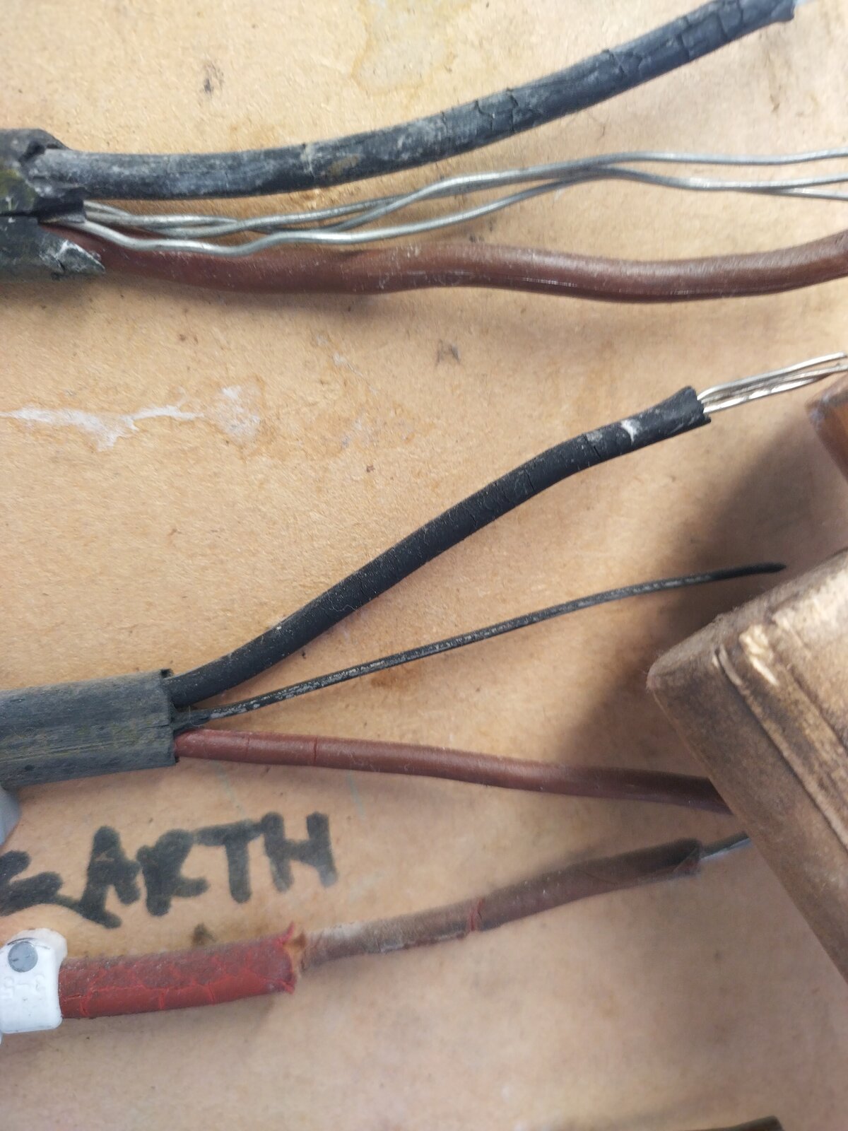

I have a board with samples of cable over the years that I made as a teaching aid.
One of them is rubber lighting T&E with a single strand cpc.
