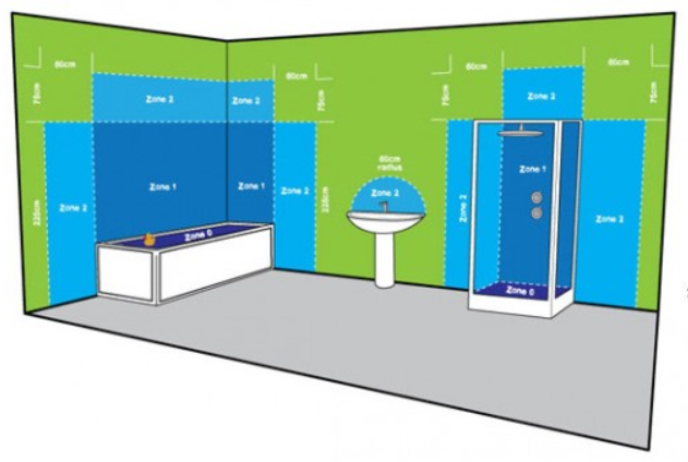

So based on the regulations it appears that 6 out of the 7 downlights are in zone 3, the only downlight in zone 2 is above the shower cubicle.
The author in that link suggests a minimum IP44 in bathrooms despite the fact that zone 3 does not require them to be, that's fair enough I suppose.

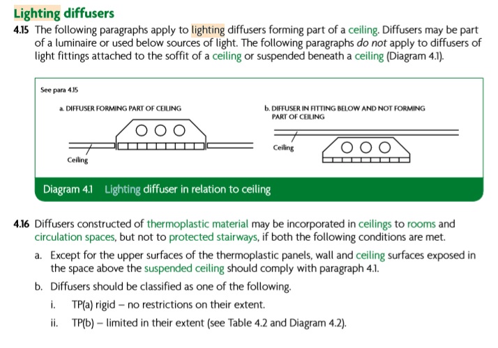

In terms of fire rating, I'm browsing part b.
This is the only section I can find that relates to lighting.
Is a downlight classified as a diffuser ???
