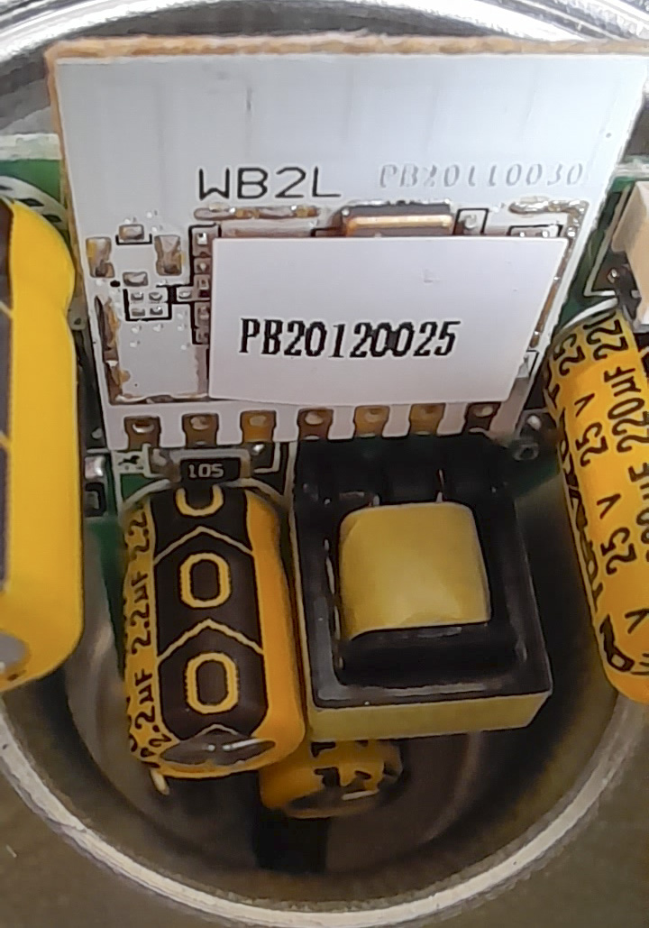

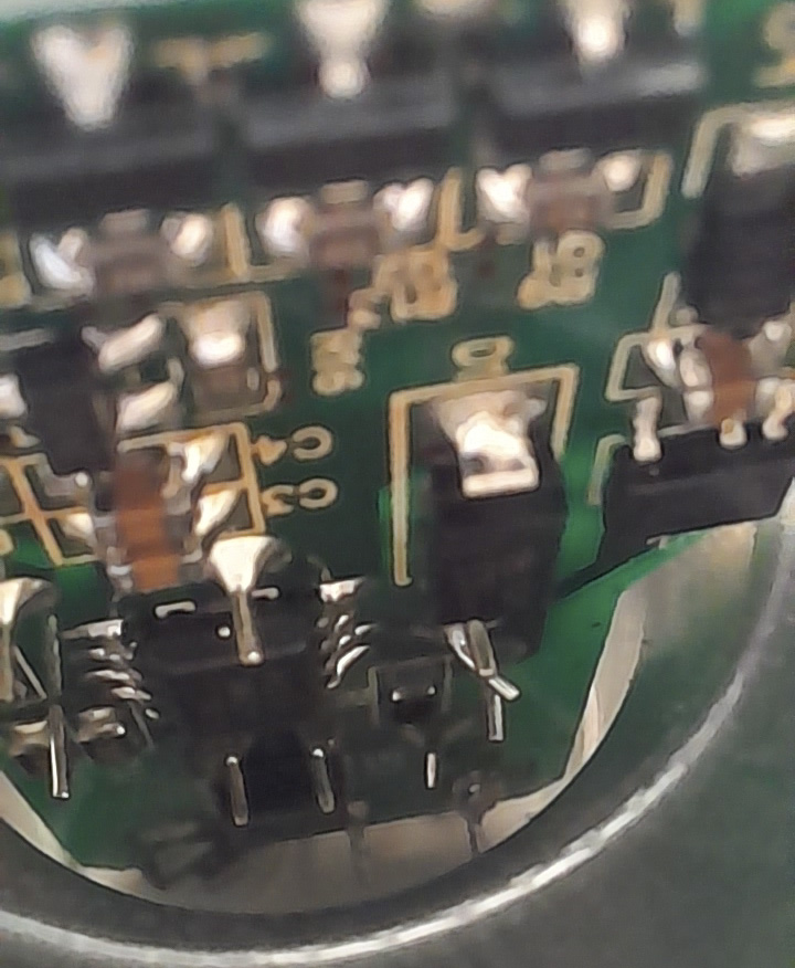

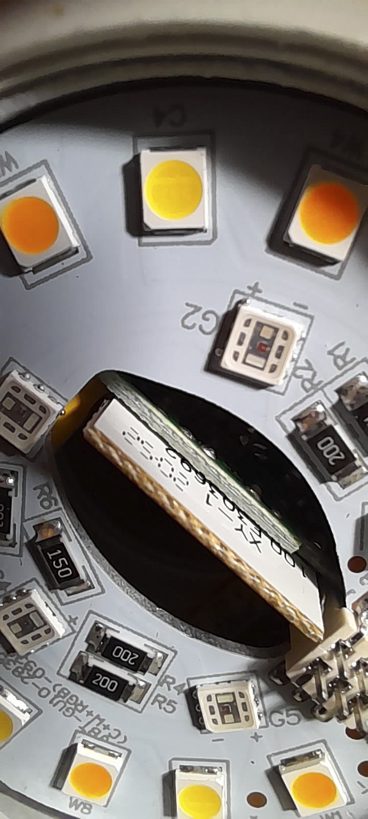

The LED lamp can be simple, it can also be complex this GU10 20220603_113820_1.jpg 20220603_113835_1.jpg 20220603_113222_1.jpg has a far bit hiding under the LED plate left, as to if the transformer is 50 Hz not sure, the lamp failed or would not have opened, likely the capacitors mean it is smoothed, but the big question is can damp enter that void, and will spikes cause premature failure.
This one is colour changing zigbee so maybe not fair to use as an example, the G9 bulb I opened was very simple in comparison, six pins connect the plate with the LED's to the unit below it, likely red, green, blue, white high temp, white low temp, and return.

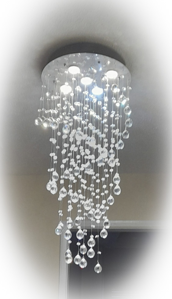

However the low voltage is deep within the unit, near the surface we have extra low voltage, so unlikely to present a danger. I bought a pair, the one stripped was tested in kitchen, it did not last long, second in the landing light, only been up a few days, lamp-landing_1.jpgthe centre one is colour changing the 4 outer are simple on/off although controlled with a zigbee relay so can be controlled by the phone.
I am crossing fingers and hoping it lasts.

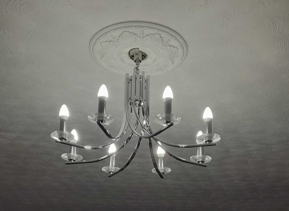

Daughter has problems in my living room, she gets a head ache, she blames it on LED bulbs, but again no proof, 20220415_000328_1.jpg how can one work out if the bulbs have a strobe effect? It does not cause a problem with my wife and I.
