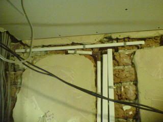

Not electrical but that blue water pipe above the kitchen ceiling....did you lag it before boxing it in ?
You may find you get condensation on it that will drip onto the ceiling and create a damp patch.
Yes the blue water pipe for the outside hosepipe tap, has been lagged, before boxing it in.
Here are some more pics of the new electrics

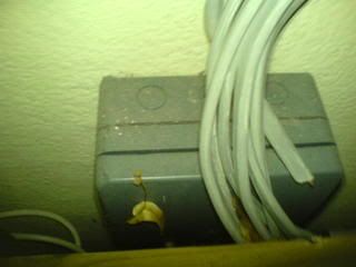

Cables above the ceiling
5 downlights cables
3 downlights cables
Cables above the new ceiling

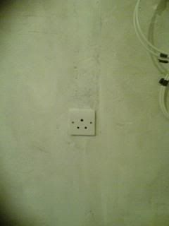

Fridge double socket
Cooker hood cables
Cooker Hood socket

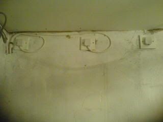

the 1st under cupboard lights socket

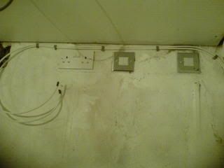

Holes for DSO, 2 FCUs & a 15A Round pin socket (below worktop, fed from 1 of the FCUs)
TV & under cupboard lights cables
The 2nd, 3rd & 4th Under cupboard lights sockets

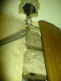

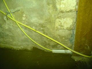

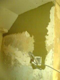

Hole in floor on sink side, filled, & new earth cable (It is the one coming out of the piece of conduit, by the back door. The other earth cable is the old one)

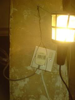

Here are some pictures of the temp. courtyard (Utility Room) light
The light
The switch
The supply cable
The light just plugs into a socket in the dining room

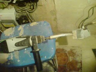

What are you using to chase the walls?

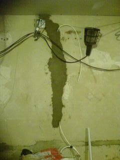

Temp. Lighting JB (Upstairs & Downstairs Lights, fed by 1mm flex with a plug on the end)

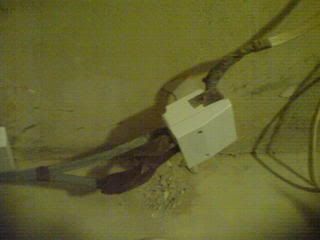

Hob & Shed power temp. JB

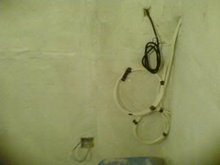

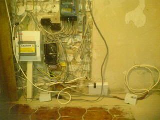

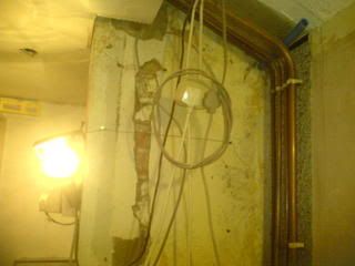

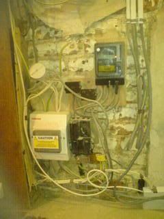

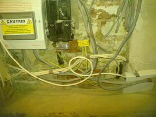

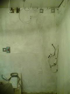

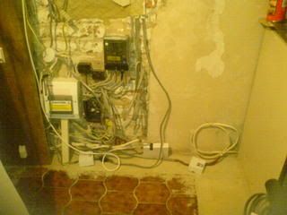

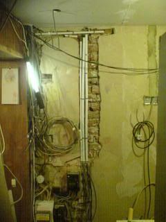

This picture highlights a problem to come.
The incomer is now obstructed by cables so there is going to be extra complication when the DNO try to move the cutout onto a new board.
I repeat DO NOT attempt to move the cut out. IF you REALLY must DIY the new board make it an upside down U and fit it around the cutout without disturbing the cut out or the incomer. A short circuit in your wiring will trip the MCD and / or MCB and remove the power within seconds ( assuming you have wired correctly ) but a short circuited incomer or damaged cut out is a very different matter. There is no protection other than a very large and very slow to blow and may be auto re-connect breaker at the sub station.
and one more point you may have overlooked.
The problem with posting photos is that the short cuts and corner cuttings that would never pass inspection if they were seen have been seen and can be seen as often as is necessary.
Sorry to be hard on you, you obviously are dedicated to the project and have put a lot of work into it but there are some things that are boderline on quality.
And WHY OH WHY are you STILL carrying on this topic in TWO THREADS? :eek:
Good question.
As this thread is just about the kitchen electrics, & the other thread is about replacing the kitchen as a whole.
The Lighting JB can just be moved out of the way, the other cables will lay on the floor if I unhook the hob cable off of the cable clip, & the other cables are the main/bonding earth cables & the tails to the CCU
What short cuts & corner cuttings :?:
What things are boderline on quality :?:

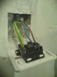

More pictures of rubish please, perhaps a couple of bags of 2nd fix offcuts sweepings would be nice. Oh, and maybe a few shots of the empty cardboard boxes from the accessories, preferably broken flat.
Well some of the cable runs could be a little neater especially in the celiling void. But i remember some of the first jobs i did where not very tidy i was always told it will come with time. :D

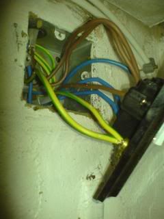

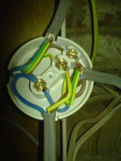

Here are some more pictures

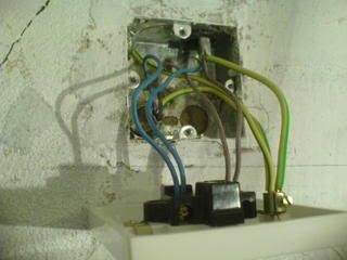

15A Round Pin FCU wiring
Under cabinet socket FCU wires
Under cabinet socket FCU wiring
DSO & 2 FCUs

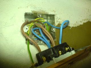

15A Round Pin Socket wiring
The Finished 15A Round Pin Socket
cables

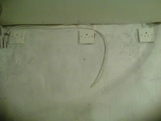

3 undercupboard lights 5A Round Pin Sockets wiring
the 3 finshed 5A Round Pin Sockets
The wiring in one of the 5A Round Pin Plugs
3 Undercupboard lights sockets

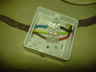

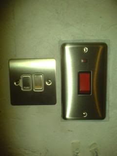

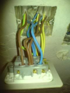

Cooker Hood FCU & Cooker Isolator wires
Cooker Outlet Plate wires
The Cooker Cable is 10mm T+E & the Cooker will be on a 45Amp Type B MCB
Cooker Hood FCU wiring
Cooker Isolator wiring
The finished Cooker Hood FCU & Cooker Isolator

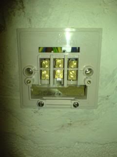

Cooker Outlet Plate wiring
Cooker Outlet Plate

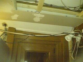

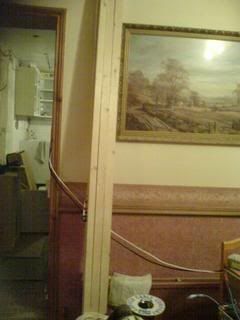

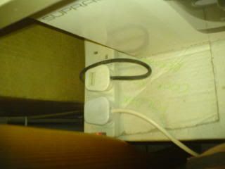

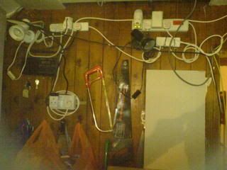

The Temp. electrics
Temp. Electric supply
(the piece of wood under the CCU, is all that is holding it up as the render on the wall behied it came off)

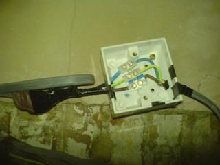

Temp. Cooker JB
Temp. Shed JB
Temp. Shed power & Shed freezer JB

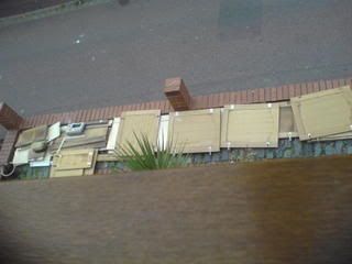

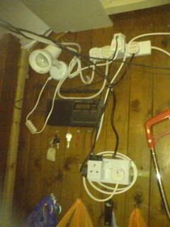

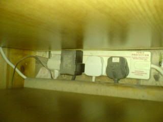

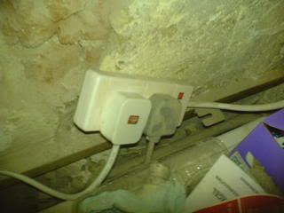

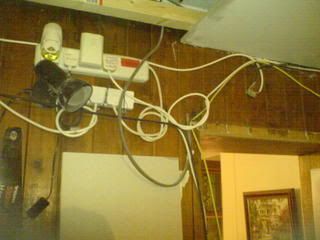

Temp. Kitchen Power
Temp. Kitchen Power, Extension Leads
Temp. Kitchen Power, Extension Lead 1, & Temp. Double Socket Outlet
From left socket, of extension lead 1: 1st plug is Tumble Dryer & Wine Cooler, 2nd Plug is Washing Machine & Kettle, 3rd Plug is a Radio & White Spotlight, & 4th Plug is the power to the Temp. Double Socket Outlet.
In the Temp. DSO is: 1st Plug is the 2 temp. Kitchen Lights, & the 2nd Plug is the Back Garden Floodlight.
Temp. Kitchen Power, Extension Lead 2
From left socket, of extension lead 2: 1st plug is the air fresher, 2nd plug is the Black spotlight, 3rd plug is the door bell, & the 4th plug is the power to the temp. upstairs & downstairs lights JB.

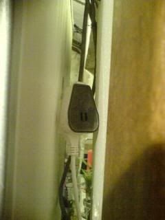

The black extension lead, which comes from the dinning room is the power to the fridge.

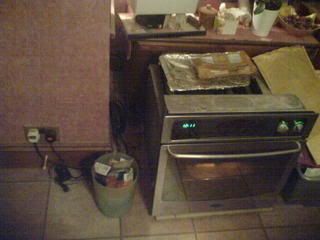

The temp. cooker

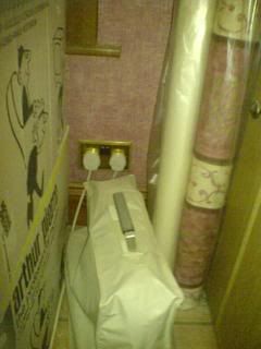

Fridge & toster supply
Temp. kitchen supply & microwave power
(it is the 2nd plug in the socket)
Temp. power cables into the kitchen
Temp. fridge supply
Temp. power cables
Kettle & Washing Machine supply
Bathroom Light, Tumble dryer & Wine cooler supply
Temp. bathroom light supply

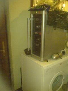

Temp. outside socket for Tumble dryer & Wine cooler
Tumble dryer & Wine Cooler

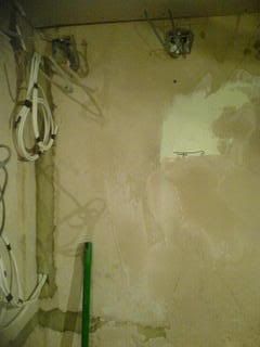

Some more pics

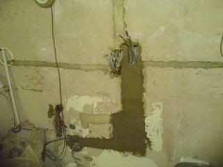

Cables to outside jbs
Cables for 2 new ring circuits

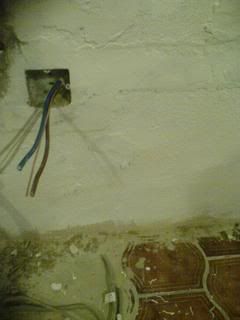

1st kitchen light switch cables
The cables cemented over

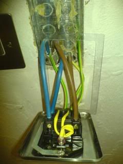

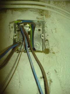

Cooker hood socket wiring

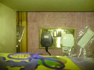

Cooker hood socket
1st undercupboard lights socket
Cooker circuit supply cable
Cooker outlet plate wiring
Cooker connection box terminals
