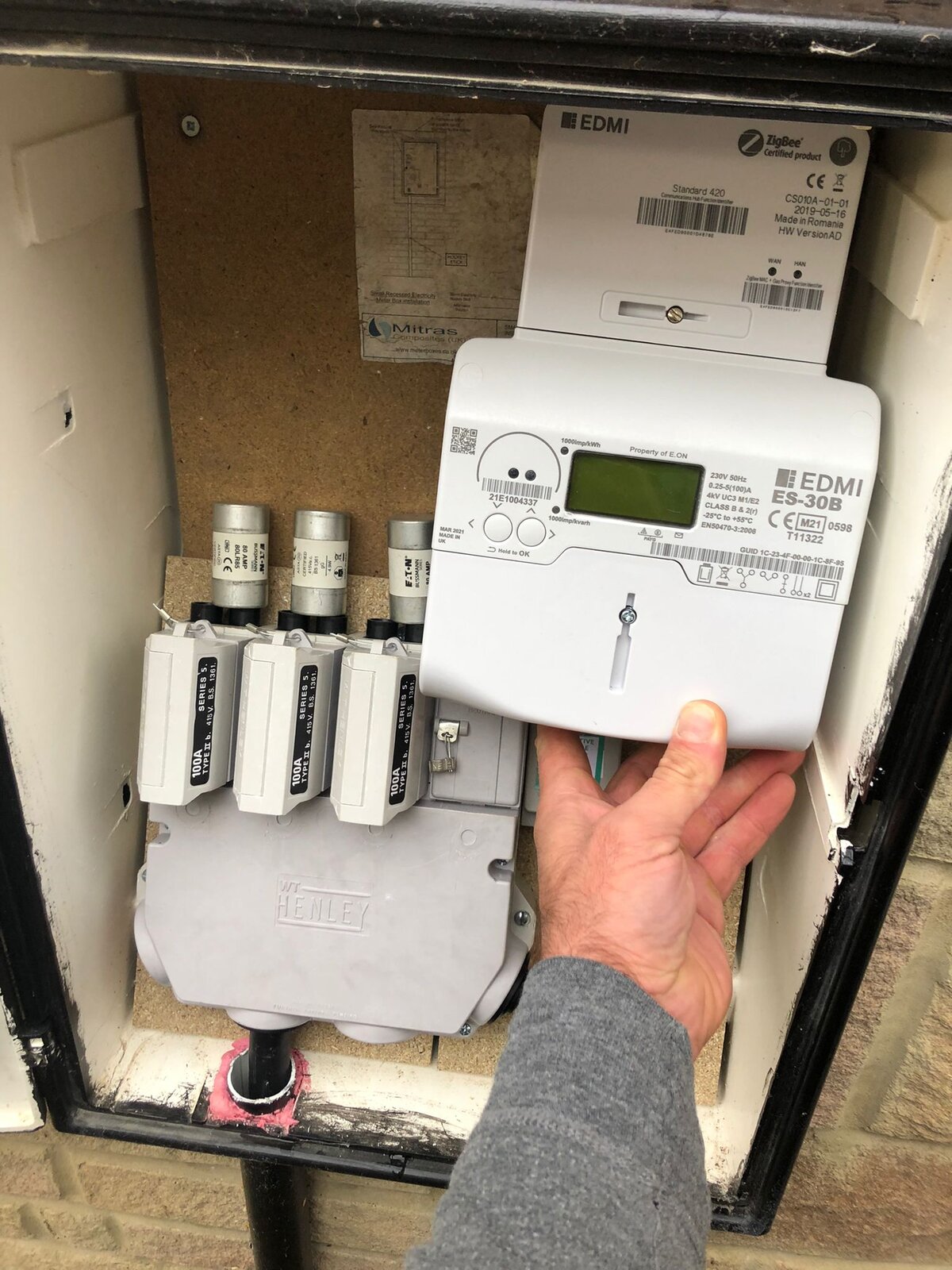

Just to clarify it was not that EON refused to fit the 3 phase into the box, it was that it would not physically fit above the cut out.
The installer from EON tried to place the smart 3 phase meter that they fit into the meter box but it was simply too tall due to the extra bit at the top that contains all the "smart" stuff.
He even showed me what I believe was a standard "shorter" 3 phase meter and although this fit above the cut out it only left minimal room for the cables.
However I can't remember if he tried to fit it above and to the right of the cut out so I'll have to investigate this.
I'll add looking for a different meter to my list of possible options as EON may be willing to fit even if I have to supply it. (y)
Upon looking at my photo (re-attached to this post) it looks to me that they could have placed the cut out lower by 50mm or so?
The actual space available is 340mm wide by 250mm high which makes me wonder if they could fit the meter on it's side?
I'll be adding both of those to the list of potential options.

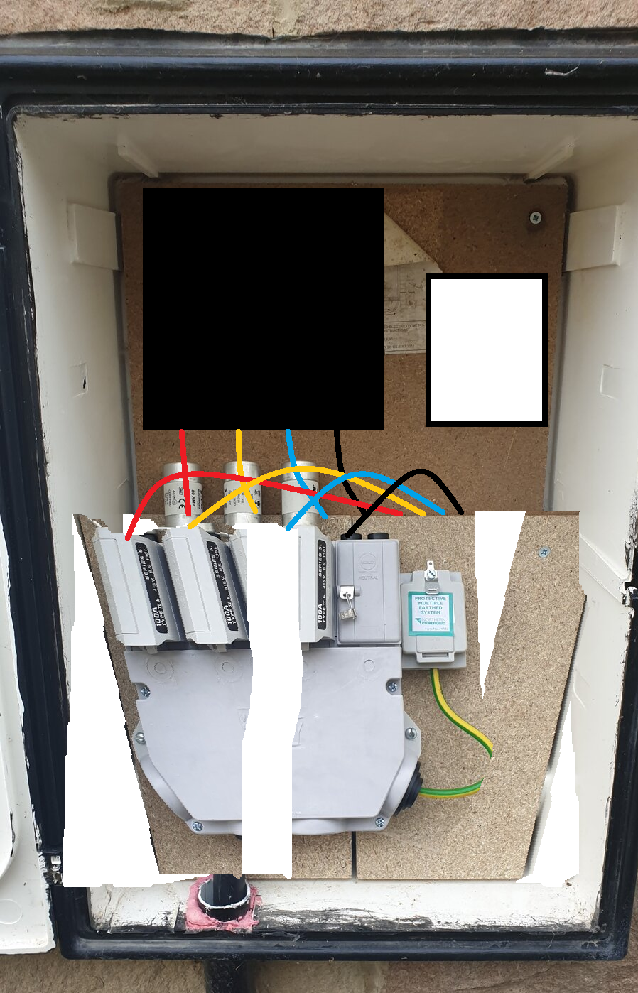

I thought I'd seen a pic but only looked back to first page for it. Personally I'd be unscrewing the sloping back board and re fixing it such that the tails under the meter can drop down behind and curl back over the top to the cutout.
Does this make sense?:
And there shoud se space for the isolator

I can think of absolutely no electrical reason why a meter could not be fitted 'on it's side' and I don't think I've ever seen a smart meter which would not fit into your available space if that were done.

Thanks for that idea and it does make sense but even then I do not think it will fit.
I've added a photo of the actual meter..
Unfortunately when I asked the EON Install Team Leader he said they could not fit it on it's side, I get the feeling that unless it's been tested and approved they will not do anything.
They have also said they cannot fit any other type of meter, only the ones they stock.
NPG are going to come out on Monday to see if they can do anything to create the extra space by moving the cut out within the box but I think the only real option is for them to fit a red link in the garage.

Blimey, I know I said the tend to be a bit bigger but...
With the meter in that position and from tha photo angle it looks like the 3 fuses are clear of the meter widthwise and the neutral connexion is nearly clear heightwise. In my opinion i'd be looking at creating a backboard just big enough to take the meter and way forwards so the meter is just behind the door. Reduce the width of the sloping back boardto the right of the C/O and it looks like that will create loads of space for the tails. There will be plenty of space above the C/O for the isolator.
I'll also add the C/O could be lowered but will mean digging to lose a bit of cable and maybe moving it to the left just a few mm too.
I'd get it in there:)

Quite so! Good grief - what on earth is that massive bit added onto the top, I wonder? - the actual ES-30B 'smart' meter, per se, does not appear to have that - so I wonder what the add-on bit achieves which the 'smart' meter itself doesn't? ...
... Unfortunately when I asked the EON Install Team Leader he said they could not fit it on it's side, I get the feeling that unless it's been tested and approved they will not do anything.
Possibly. I cannot find an installation manual on-line (only 'data sheets', which say nothing about installation orientation). E.ON presumably do have an installation manual- so you could ask them to show you where it says that it cannot be installed on its side?
I suppose that was inevitable. It's very probably just a matter of money, so if you could find the right person to talk to, they might agree to fit something different if you paid (fully or partially) for it.
As for the latter, as I asked before (and I think your answers were "no" and "don't know", respectively), do we know whether they would be prepared to fit the 'red link' cutout and, if so, at what cost?

No I have also looked so see what the additional part is but I haven't been able to find it.
EDIT: It's a communications hub variant .... https://www.edmi-meters.com › uploads › 2019/05

However, what is a communications hub "variant". Does not the ES-30B have a built in communications facility and, if it doesn't, in what sense is it a 'smart' meter?

However they also told me that the cut out the original people had fitted was the wrong one anyway and the one they should have fitted was smaller, hence it is possible that if they had fitted the correct one then EON would not have had an issue fitting in the smart meter.
