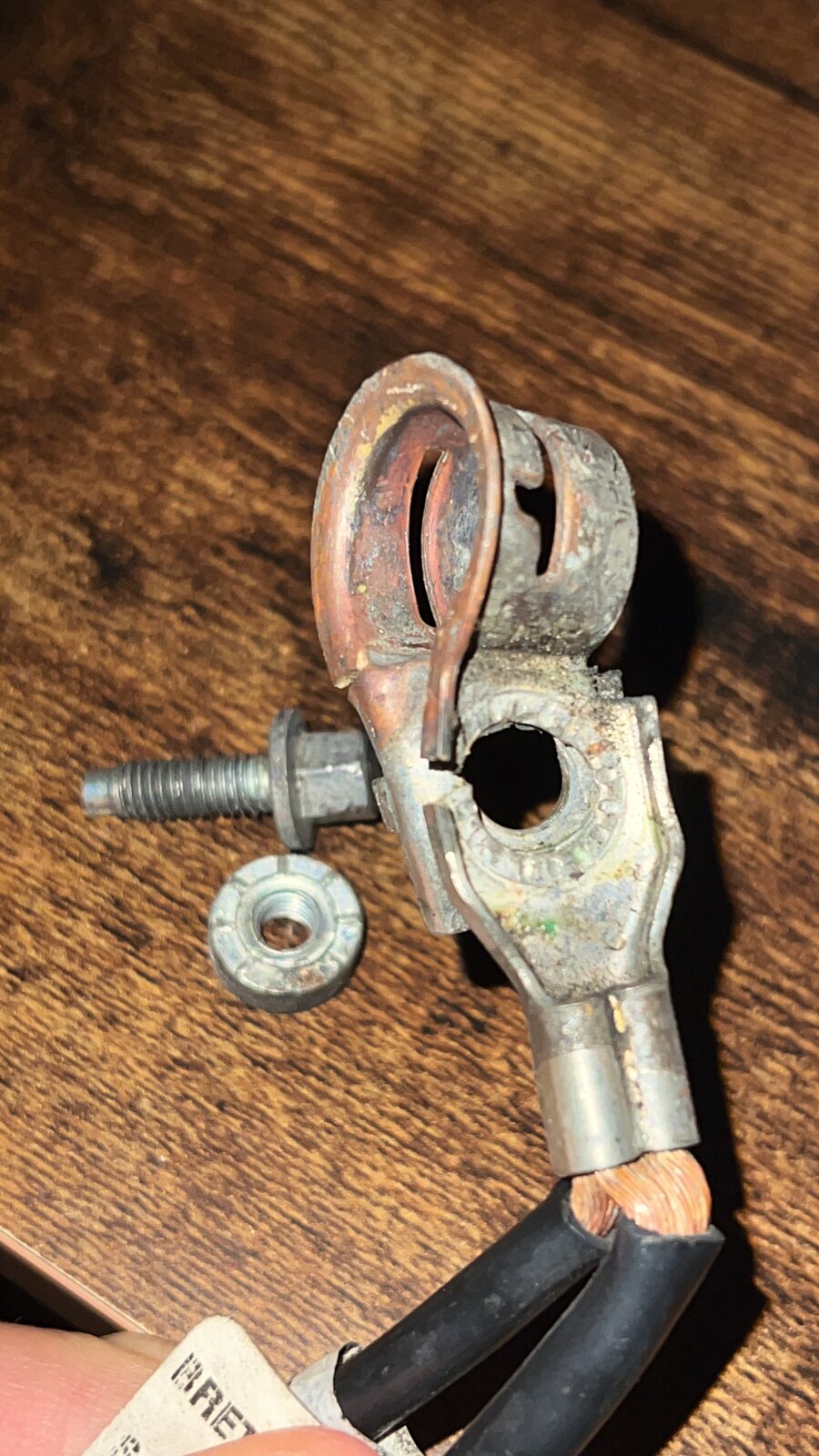

After reconnecting the battery, you’ll see that the clicking doesn’t happen until attempting position 3. As I turn the key back to the neutral position and restart the process, the clicking begins at position 2. Very confusing lol.
But yes, as mentioned I have purchased a new battery, new negative terminal cable and replaced the starter motor. Could you be more specific when you referenced “connections at battery and body/starter are good?” please?
Interestingly the negative cable was pretty worse for wear as you’ll see above and therefore I’ve replaced it, but the Citroen Saxo had two parts for grounding the wire out of the single negative cable. It’s hard to come by sourcing the same as the OEM, would replacing with a new cable that only has one grounding/Earth point make a significant difference?

New battery terminals fitted ?
Hmm yes that terminal clamp doesn't look like it would have made particularly secure, low resistance connection with the battery terminal post
Not if the earth connection is good at both ends
By good I mean that the bodywork/battery post and the cable end are dry bright metal with a good surface area, no paint, no rust/oxidation, no scummy build up of dirt etc, the bolting is secure and the connection is coated with something that will inhibit corrosion (general and galvanic)

I’d definitely replace that battery clamp.....it’s goosed and motor factors have replacements that allow the cables to be screw clamped in.
One cable should go to the bodyshell, the other to the engine block directly.
Did you just replace the neg cable to the body/chassis? Try a jump lead from the battery neg terminal to a good earth on the engine.
