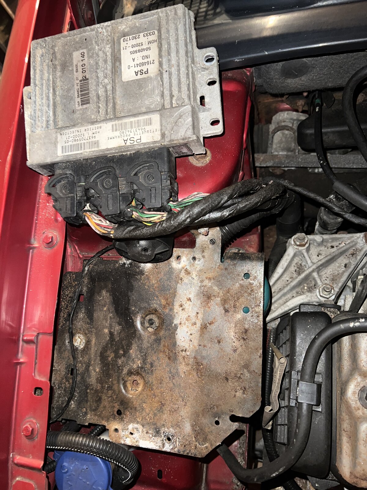

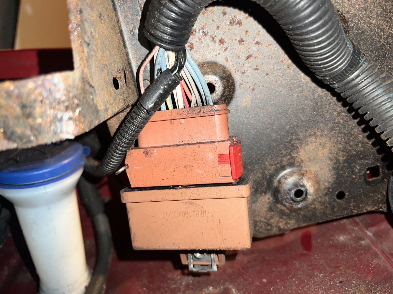

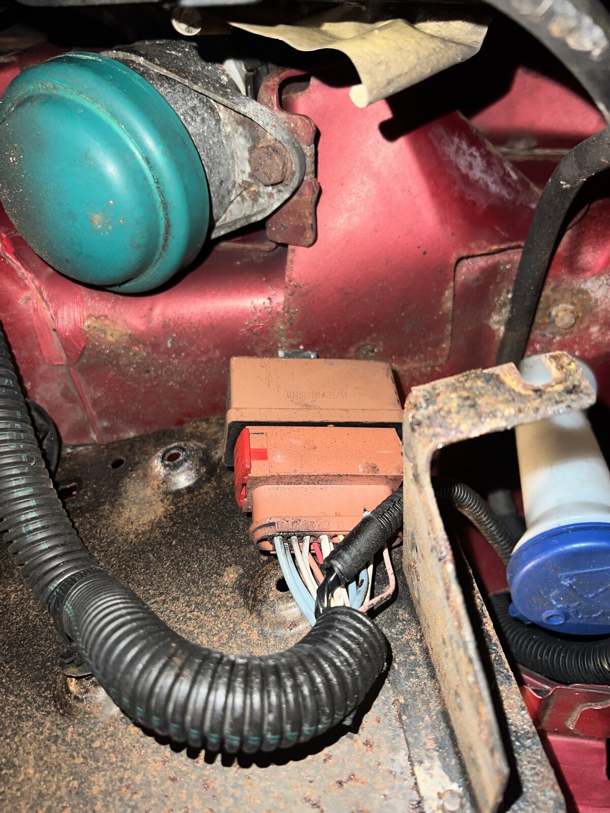

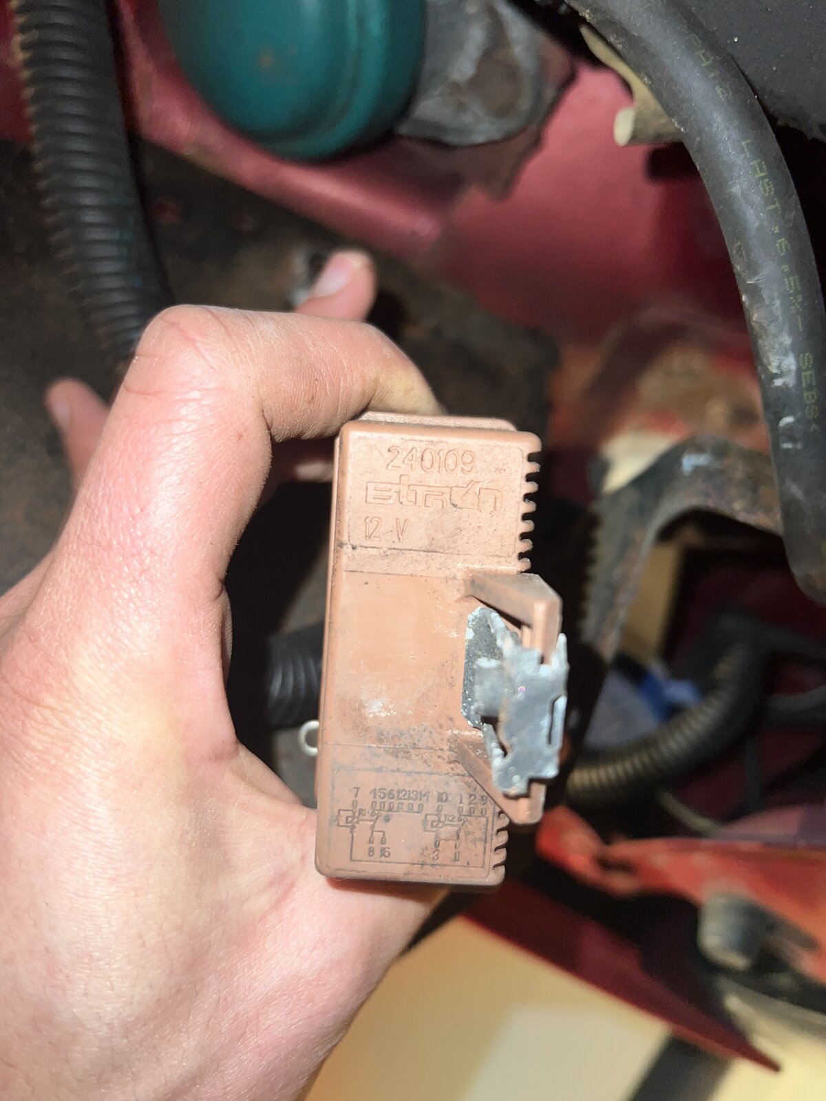

Removed the ECU out of the way… you’re right, the clicking originated directly underneath.
To this beauty… now again, I’m a complete novice here…
Someone please tell me what this? Hahahaha

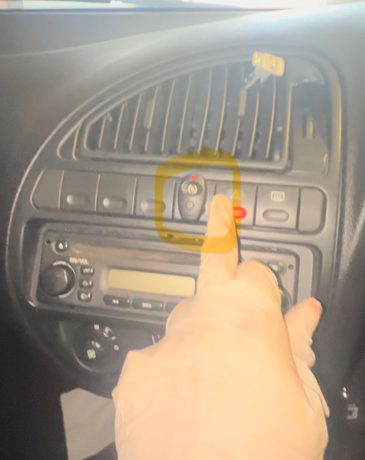

And I may be completely wrong, but I wouldn't be surprised if there were an aftermarket immobiliser fitted somewhere, for the sake of insurance premiums, on a model like this.
It could be an extra complication in the diagnosis?
You’re probably not wrong. Saxo’s were the hot hatch days! I think this has something to do with the alarm/immobiliser…
