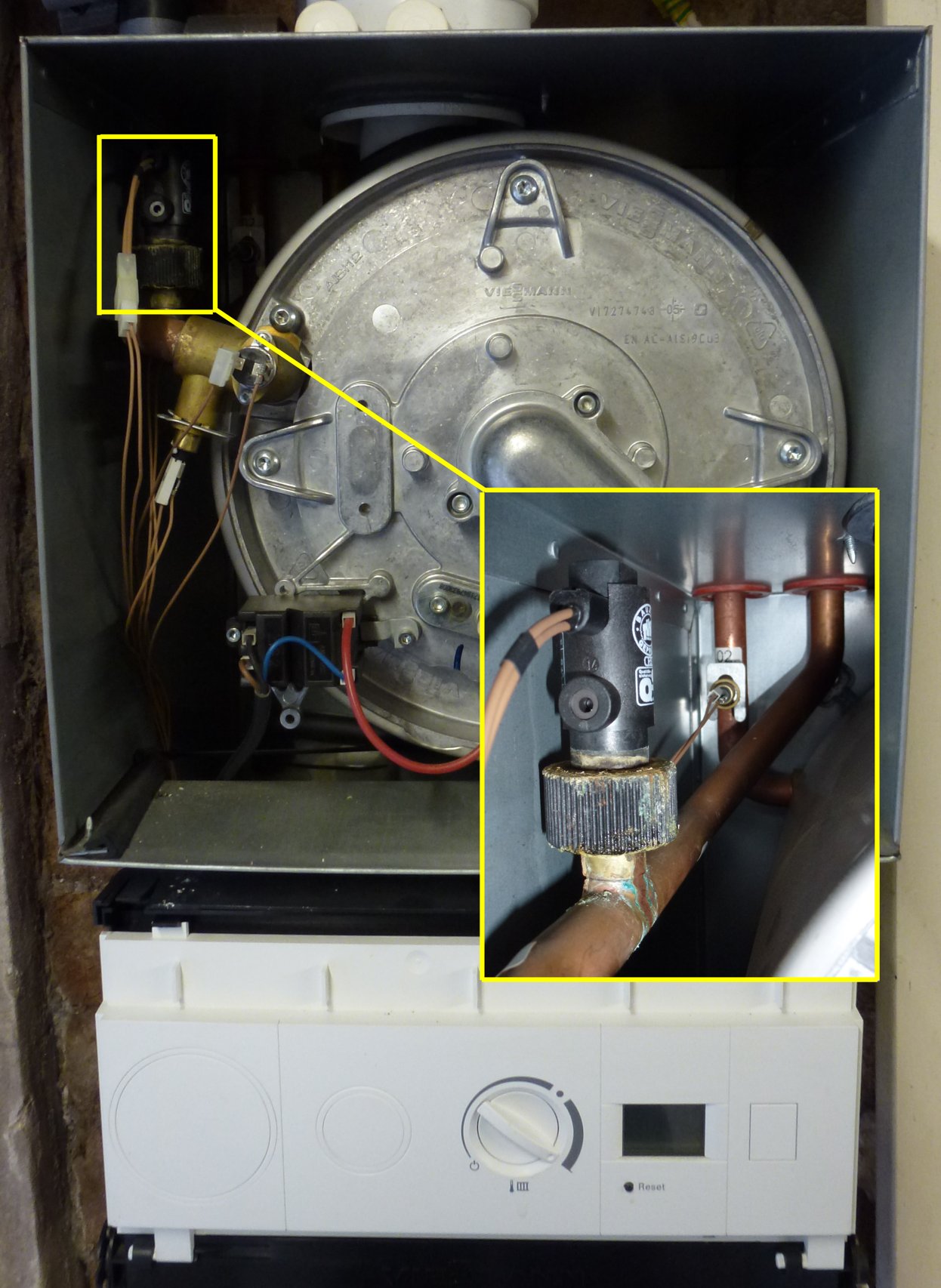

What is puzzling me is the precise on/off temperature of the boiler - 41C/60C for CH. It is as if it is internally set. So I have suspicions about the boiler.

What puzzles me is the precise on/off temperatures of 41C/60C. Now the maximum temperature setting on the dial should be 80C while the 'efficient' setting on the dial should be 60C. Is it just coincidence that it is shutting off at 60C each and every time, or could something on the PCB have failed?

I spoke to Viessmann technical support today. The boiler works at 20C differential, which could explain the on/off temperatures. It is quite normal for the LCD to show only 2-3 out of 5 bars. He said I had a flow problem, probably the return, and the boiler is OK. There is less flow when CH and HW are both on than HW alone (I did not understand this). The heat exchanger is unlikely to be blocked because the pipes are large diameter. I was not entirely convinced by what he says but have to accept it for the time being.
Prior to calling, I had a look inside to check part numbers. The flow switch looks as if it has leaked, but is quite dry at the moment. Could this be a problem?
No. Why are you not entirely convinced?
