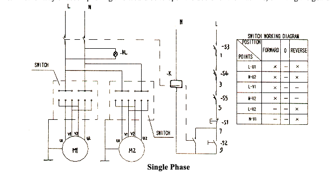

as I say, it is rated as a 150µF but my multi meter calculates it as 192. I have little experiance f measuring capacitors so don't know how accurate it is. (I have a spare one rated at 30 which measures at 23!)
It is certainly the belts that's causing a load too great for the motor, but that clearly is a fault somewher, when the motor gets to speed, it is amply powerful. Interesting ly if I configue the belts for the slowest milling speed, it will run, but configured to the fastest speed (which will be more work for the motor) and it fails.
This image shows the switch (i don't know what make it is) and the For/Rev switch is what I would describe as a double-throw. .6 connections. The outer pairs are double wired, so 8 black wires presumably heading to the motor but curiously only 4 arriving (2 blk blu & Brwn) arriving at motor ! where they change over I have no idea.
it's certainly more interestig than a book of suduko puzzles. And I would love to figure it out.
would also like to get it working, its a decent size machine and feels very solid, should be able to remove more metal in each pass than the other mini thing we have.
There doesn't appear to be a self-tensioning idler pulley so forget the varied slip argument. Your photo doesn't show the reversing switch (or it's jumble of wires) Can you photograph the switch and it's wired connections. Do you have the manual for that particular machine complete with wiring diagram - if so a photo of the wiring diagram woud be useful. That machine presumably uses two drive motors, one for the drill/mill quill and one for the lathe spindle. Do both drive at the same time or is there a motor selector switch system.
I've attached a drawing from a similar type of machine that shows how the reversing switch system is configured for each motor. Whilst yours might not be identical, the drawing may help clarify things for you. You may note that no capacitor is shown on the drawing - it may be considered as being included as part of the V1 or V2 lead within the motor.

One final thought that makes me wonder if the wiring is a mess. The cover for the belts has a micro switch that prevents the machine being run with the cover off. However if you press the start button with the cover off, the motor just Hums. as if only the starter windings are being disabled. Why does it not dissable the entire motor ? does that seem odd to you?
Are you sure it's the motor that's 'humming' That safety switch will be part of the system inhibit loop and will drive a master contactor which interupts all the system electrics - typically shown as "K" in the circuit I provided. Some contactors can be prone to humming when energised. However, if the system wiring has been 'played with' anything is possible
Does seem odd (I would expect a safety interlock to fully disable the system), but there are many explanations.
I had a quick look for a wiring diagram online but didn't find one. Do you have the manual for the machine ? If not, and I have no idea whether it includes the wiring diagram, but I see they are for sale on eBay for not a lot of money.

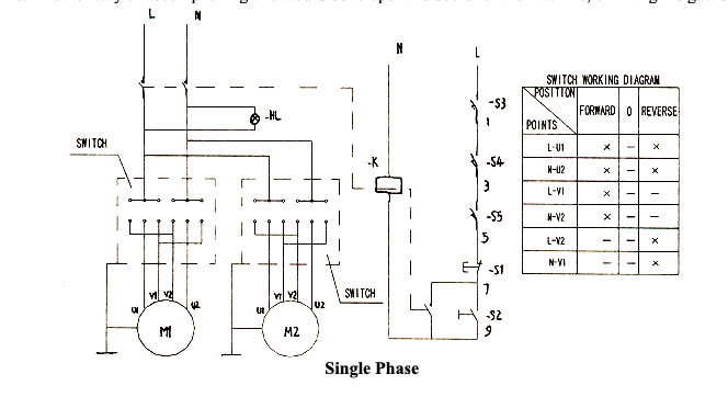

We did download this
And an image on this page

Switch K2 changes direction by swapping the connections to the second winding, either LN or NL depending on position.
The cutoff switch JWL2-11 as shown would remove power to both windings (as expected) but leaves the contactor in circuit which could be what the humming noise is.
If the motor makes any noise with the cutoff switch open, then the wiring is wrong.

No, the cut off switch removes all power to both windings and the contactor coil.
by the contactor coil, do you mean the on off switch (KJD11-10D ), When the cut-off switch for the cover is open, on pressing the start button, the motor hums until the button is released. it is not the button that hums
The set up for the lathe motor is siillar, and the motor for that does not hum under similar circumstances.
Clearly there is something amiss! the cutoff switch must only be isolating the start up windings!
Luckily, from the wiring diagram, the lathe motor wiring is the same as the Mill. This should help a lot in sorting this out.

Printed out the wiring diagram and very carefully went through it all, re arranging one or two wires to how it should be. I believe it is all working correctly now. And the cover cut-off switch does now actually isolate the motor. However non of this improved the motors ability to start correctly
