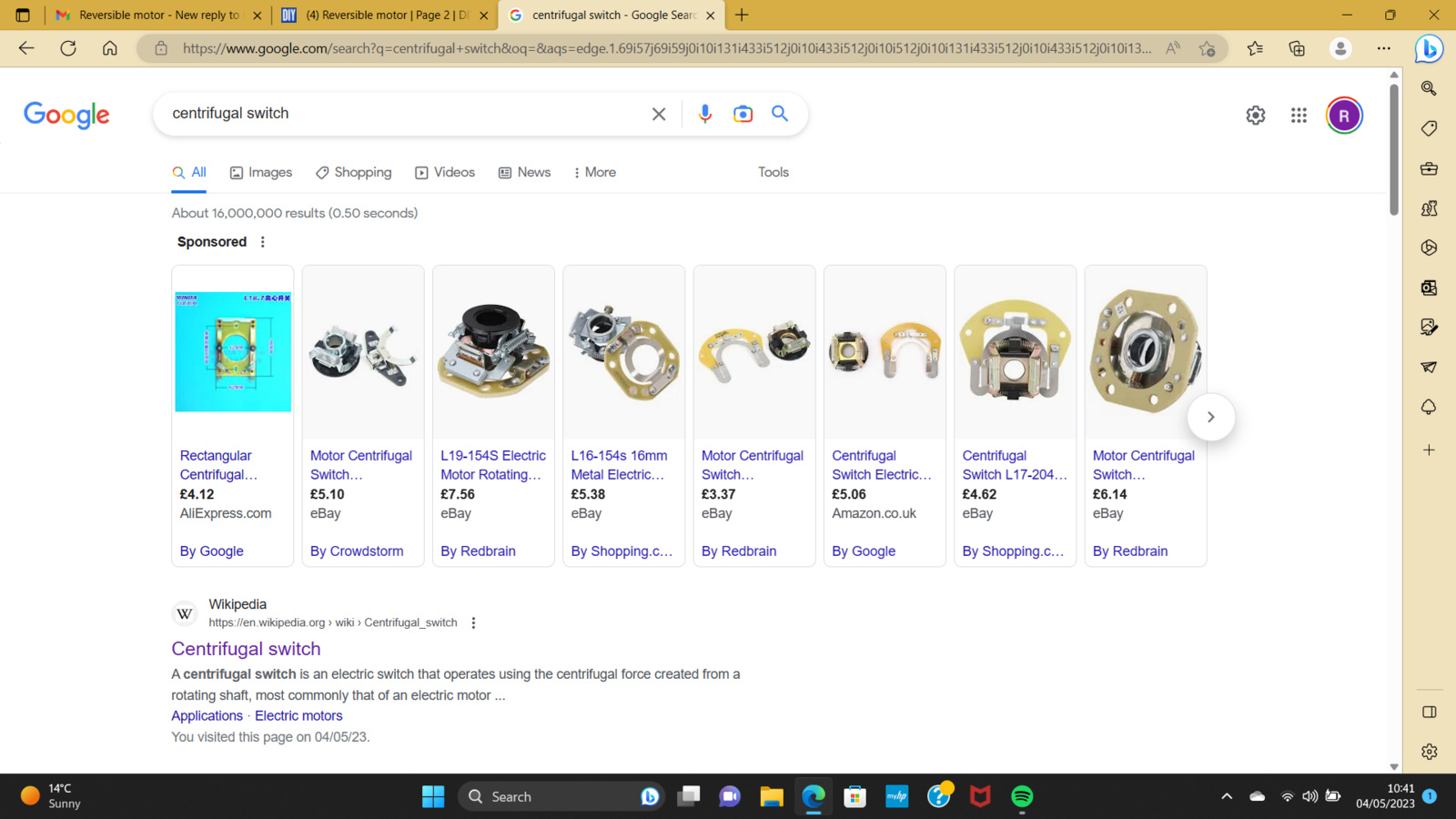

I'd be surprised if a new centrifugal switch is not available.
