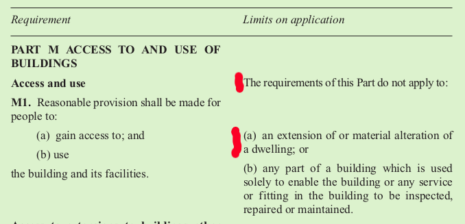

What you may *not* do, is make it any "worse" in terms of part M compliance.
That's often stated and applies in some situations, but if you read the Building Regulations carefully it does not apply to something like this, because:
For example the requirement for new builds is that all sockets and switches are between 450 and 1200 mm
And even those measurements are not an absolute requirement, only official guidance that adopting such heights would be considered to be compliance. It doesn't mean that heights outside that range might not also be considered acceptable.

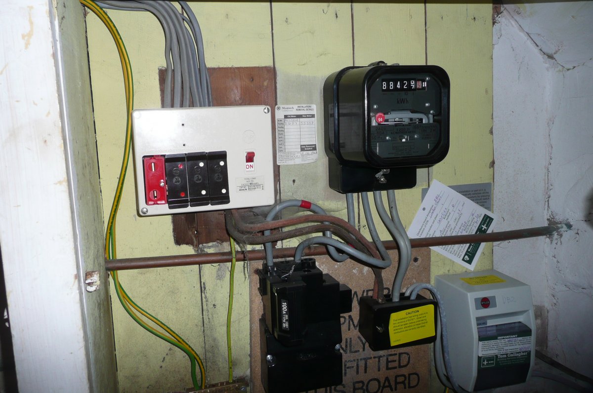

Who's responsible for connecting the new Consumer Unit to the mains tails when we do the rewire (there's no isolation switch between the main fuse and Consumer Unit)?
That pipe could do with shifting...
You can make an appointment with the DNO to cut the seal, remove the main fuse & refit, making an appointment with them to return and restore power.
Or get an isolation switch fitted and isolate and reinstate power at your leisure.
Strictly speaking this is normally the sequence:
  1. Your electrician installs the new CU, does dead testing etc.
  2. DNO staff come and remove the fuse.
  3. DNO staff drink tea and eat Hobnobs (other biscuits are available) while the electrician connects the tails to the new CU.
  4. DNO staff replace and re-seal the fuse.
Some DNOs officially allow qualified electricians to remove the fuse themselves. Most of the others turn a blind eye unless Something Bad has happened. It is not uncommon for electricians to be prepared to pull the fuse themselves, particularly when it's a modern cutout with good access.
