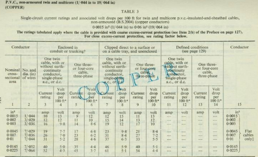

The saving of copper was a result of what they were working with.
A BS3036 15A radial had to have conductors with a CCC of ≥20.69A so 7/.029 (method C 23A) I presume.
In order to double the amperage they merely needed to complete the circuit(ring) back to the CU.
A BS3036 30A radial would have required conductors with a CCC of ≥41.37A and would have meant running a new cable of 7/.052 (method C 46A)(9.5mm² equivalent).
The CCCs do seem a bit low compared with what we are used to today but that is what is in the tables I have found.
