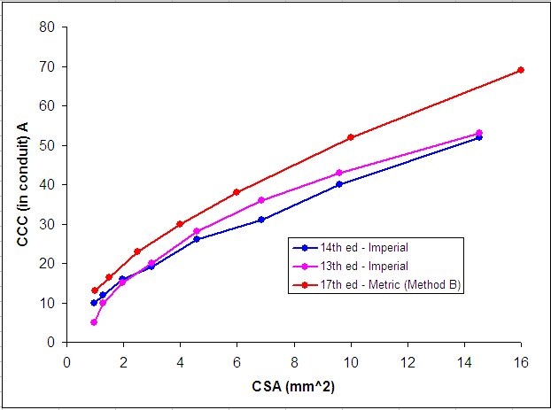

Seeing the figures from the 14th prompted me to post the equivalent figures from the 13th. They are lower in the smaller sizes and higher in the larger CSA conductors.
With a ring final you can have 106 meters of 2.5 mm cable and be within the volt drop, with a radial you can have 32 meters of 2.5 mm cable and be within the volt drop using a 20 amp MCB using a 16 amp MCB it goes up to 42 meters. So what you can find is a single final can need 3 or 4 radials to replace it not just 2 so some careful planning is required. With a 100 meter roles of cable measuring is easy, one role = one ring final. But as you move to radials one has to be careful not to exceed the limit.
Thanks. To facilitate comparisons, I've put 13th & 14th ed. Imperial CCCs and 17th ed. Metric ones together in a graph. Since the only common installation method is 'in conduit', I have assumed Method B for current regs.
The 13th and 14th are very similar, other than the differences at the very lowest cable sizes which you note (and a small 'glitch with 7/0.044), but the 17th ed. CCCs are consistently higher for the same CCC.
Kind Regards, John
