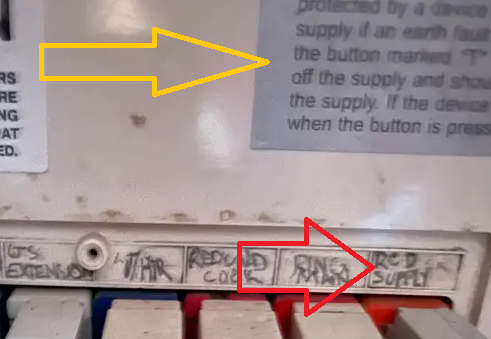

There does not seem to be any RCD protection on that ancient Fusebox.
As you should know by now, any new sockets must be protected by a 30mA RCD. So you can’t add a socket, Unless there is an RCD that we cannot see.
EDIT Oops didn't see the subsequent posts
Is my small RCD unit getting power from this breaker on the "ancient" CU?
If yes, is that common? I thought that secondary CU usually get powered by splitting at the meter tails: one set for the old and another set for the new consumer unit.
It's at my property but not my installation. I thought I'd ask since, as you know very well and remind me on every occasion, I am not an expert!

So - how do you think that might relate to the circuit to which you want to fit the sockets?
It was a tangential question. I wanted to understand how the secondary CU is connected to the main CU.
However, this does mean that I can spur off the Ring that is RCD protected. It will be a faff to get the cables to where I want them...
It also means - as someone suggested - that a new circuit could be added to the RCD unit. I appreciate that this would be notifiable.
