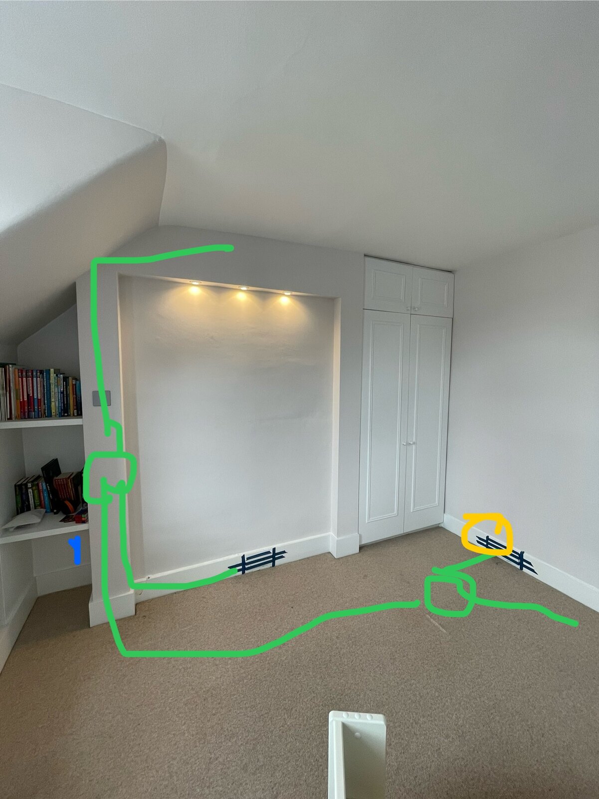

Some updates, as I finally had time to take another closer look at this... Following a "tug of war" resulting in a few scratches on my hands, I managed to remove all the old pushfits without cutting any cables and reconnected with Wago221s for now, as this made testing a bit easier.
For a start, there is actually no 1.5mm^2 cable in that junction, which I suppose is good news. The cable queried by SUNRAY, is actually going up into the loft, where it is feeding two sockets (one spurred off the other). Since the first socket is considered to be on the ring final (via JB), I assume it's fine to have one spur having a total of two sockets in the loft. Not that it matters, but they are basically unused as my loft is technically an unhabitable space.
However, after testing for continuity with all ends I found out that:
- Only 1 and 3 have continuity and therefore form the ring final
- 1 also has continuity with the socket, which I previously thought was served by cable 2.
- 1 is ALSO connected to the LED lights
- 2 is therefore still unidentified, which is annoying
I've attached a picture of the room so you can get an idea of how it actually looks like.
When I replaced the light switch on the left side, I could actually see that there is a JB (these round metal 30A heavy duty ones) screwed onto a batten inside behind the plasterboard. So I assume that cable 1 comes up from the CU, splits somewhere under the floor and goes behind the plasterboard to feed the Led lights AND the socket below the lights. It would then also have to continue to meet the rest in the wall on the right side.
So this could actually make things easier. I wanted to move the middle socket out of the skirting, but did not want to chase into the middle of that wall, which is solid plaster on brick and also a good space for a double bed sometime in the future. But now it looks like I might have access to the ring final in the left side behind the plasterboard, which is where I wanted to relocate the socket to anyway >> Just on the right-inside, inside the left empty bottom shelf. If I need to install a 3A FCU for the LED lights, then actually that would also be a decent place to put that as it would be neatly tucked away. If this turns out to be possible, then the socket in the middle could just be disconnected wholly?
I assume LED drivers never have a fuse inbuilt? i.e. from a safety perspective my best hope would be that the previous sparky took the 2.5mm^2 through a fuse behind the plasterboard to downrate for the LED? I don't want to open the entire wall so not sure if I will be able to make out the bit from the JB to the actual LEDs, but will try.

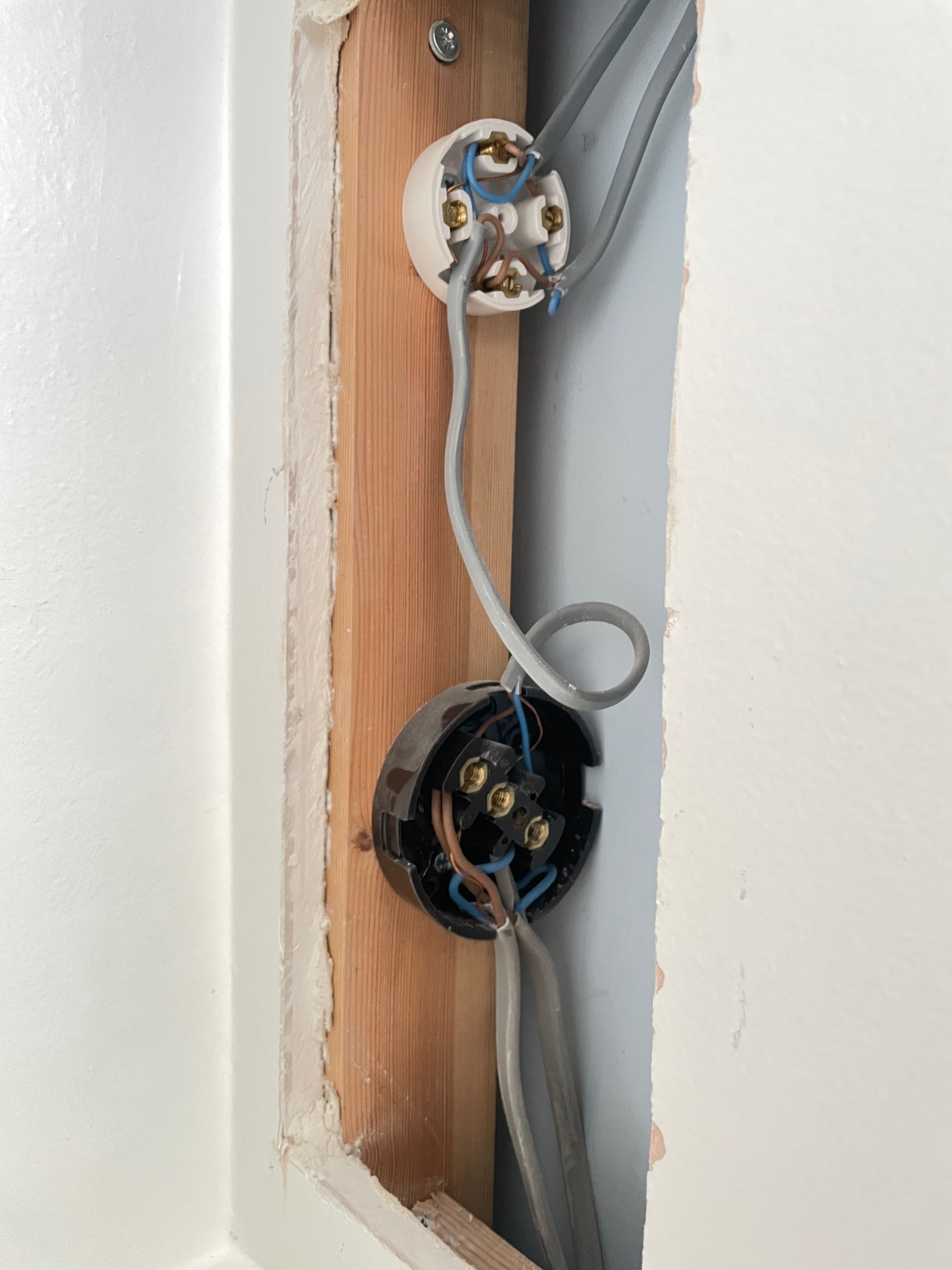

Update:
So I decided to cut a hole in the plasterboard to see the wiring. It's quite simple, the spur comes in with a 2.5mm^2 wire and enters the black 30a JB. From there it splits down to serve the socket in the middle (in 2.5mm^2) and another 1.5mm^2 cable goes from the black JB into the smaller white 5a JB. From there it's just standard light wiring feeding the LED's above via the switch.
@Harry Bloomfield (et al.) can you confirm that the safest way forward is to install a 3a fuse between these two Junction Boxes? Strictly speaking I should run a 2.5mm^2 off the black into the fuse and then a 1.5mm^2 from the fuse onwards into the white JB?
Better (if I understand it correctly) would be to take the 2x 2.5 straight into a switched 3amp fused spur unit, then from that in 1.5mm or 1.0mm. Do away with the JB's completely.
