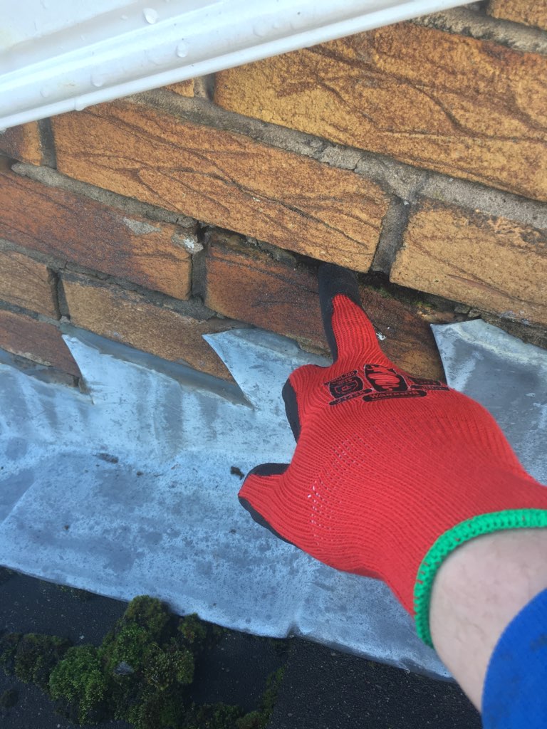

The one in the "Rendering" image show the guttering attached to our roof, not a lot of mortar around that ? is that a possibility for my problem or are you saying this is on the wrong side of the wall for it to be causing an issue? What about an issue with the dry verges - if these have just been put on over the old mortar ones could that be causing my problem especially if there was an issue with the felt/batten beforehand that we weren't aware of.

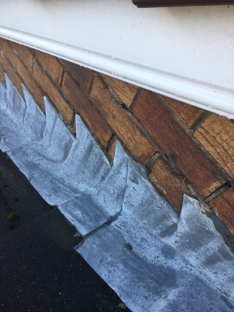

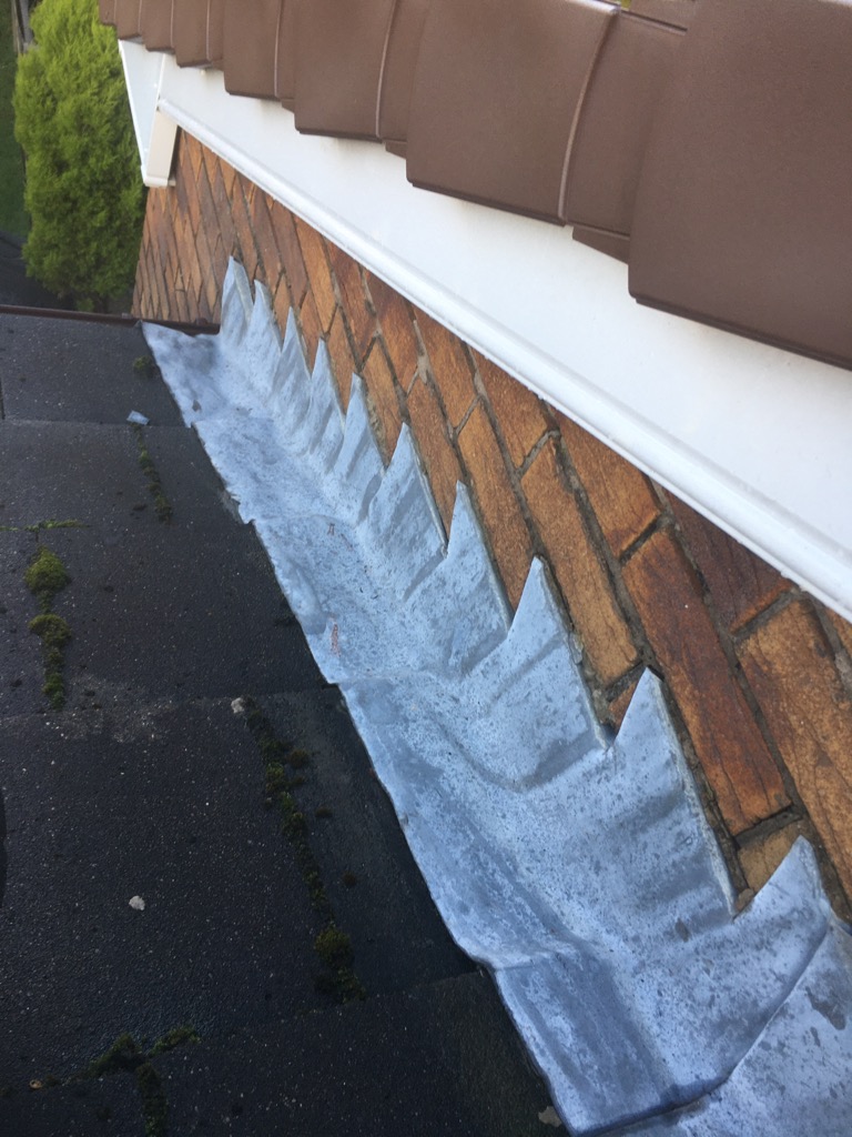

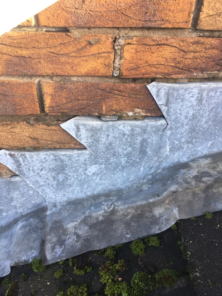

I have a roofer coming to repoint the rear of my house and replace some broken tiles and damaged lead flashing as we have water coming in through holes in the felt and he says that the lack of mortar, issues with lead flashing and broken tiles is causing my leak at the back of the house.
He is also going to mortar the front as well

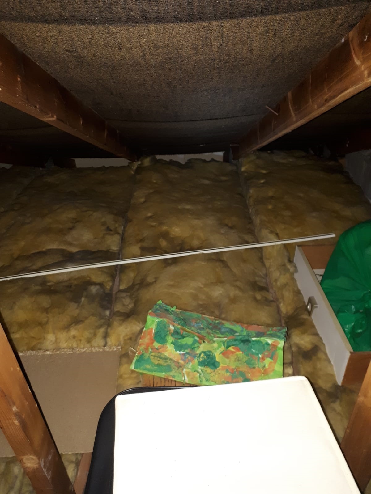

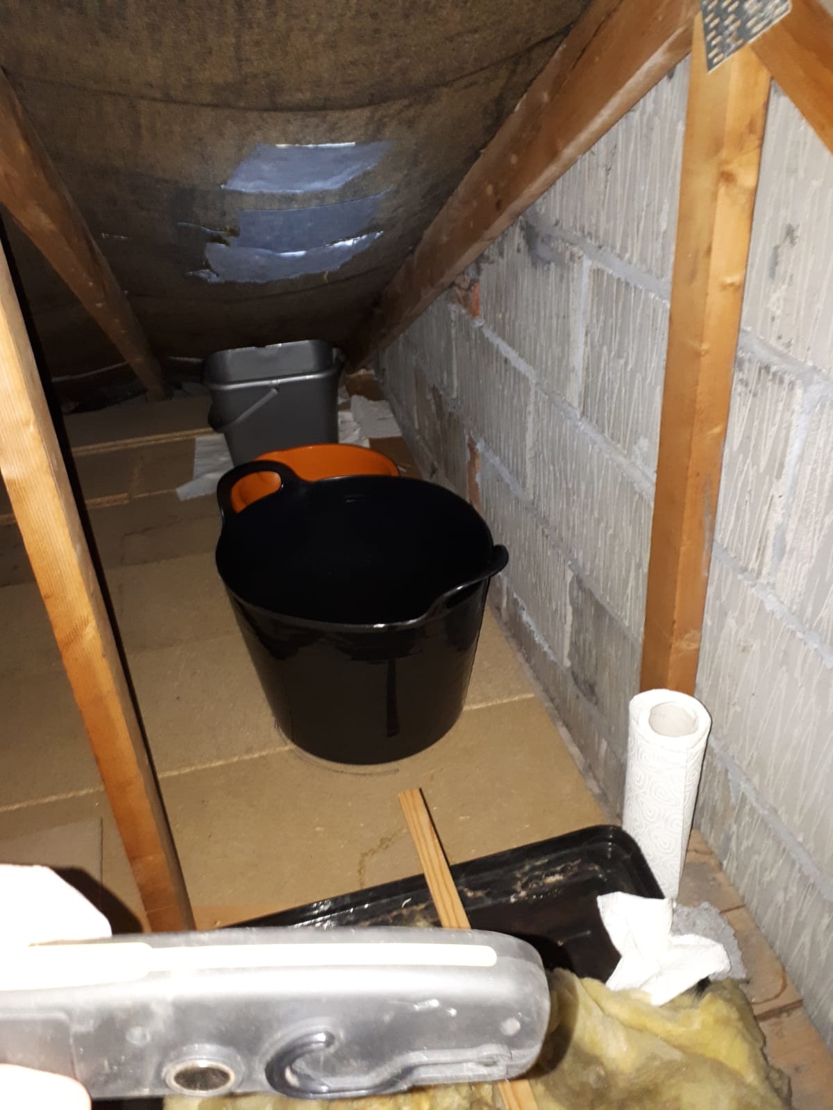

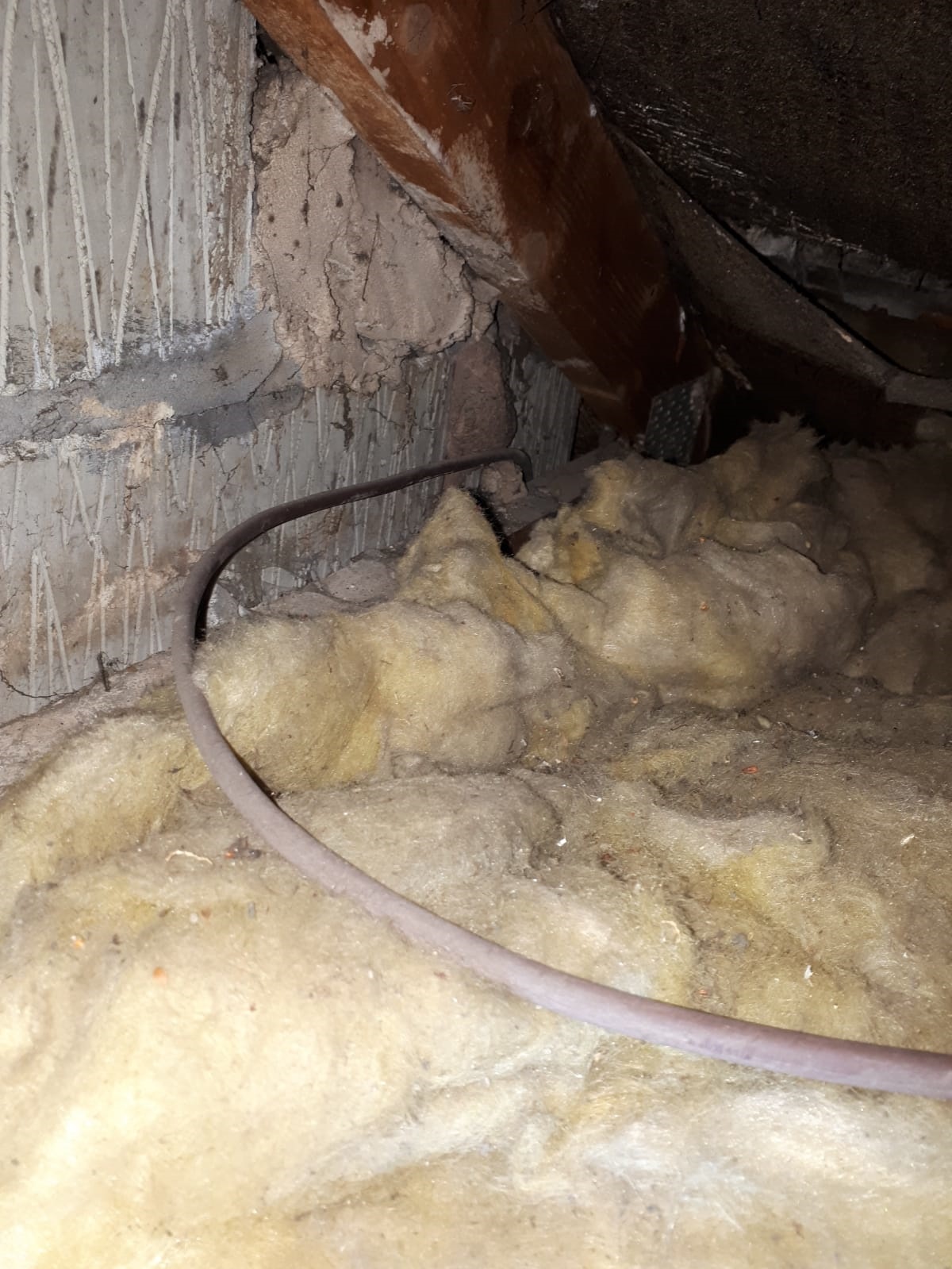

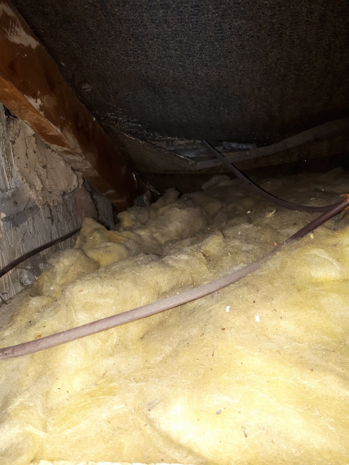

I am hoping to go in the roof space at some point today and see if i can get over to the area at the front of the house and see if i can see anything with the Cavity from the inside

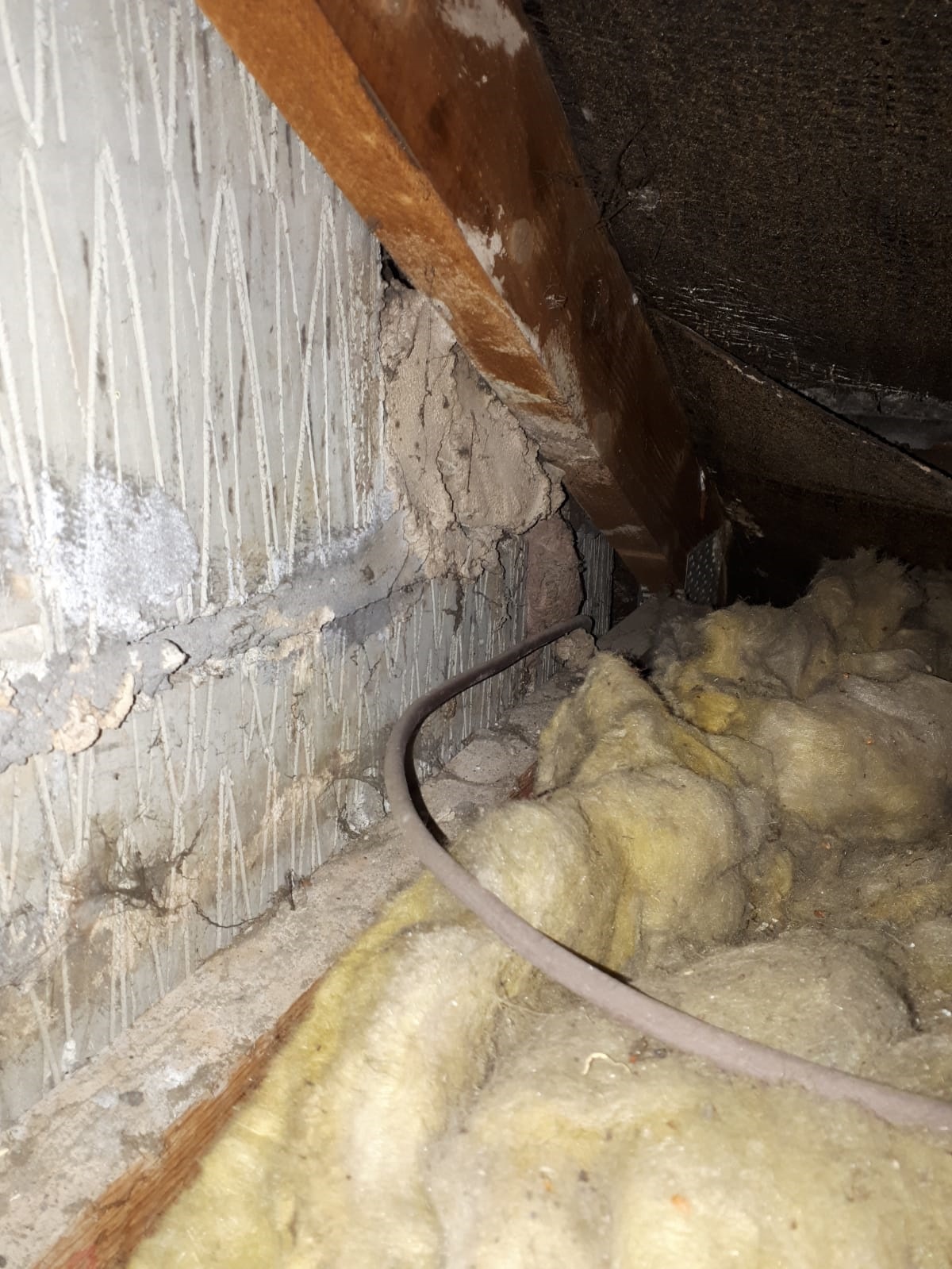

I have been in the roof space and can't see any real issues with the Cavity wall from what i see (not an expert by any means), i can see where something has been filled in previously but not sure how new that is.
Also for info pictures of felt in area and then in general at the front? How does it generally look at the front anyway?
Also added a picture of the roof at the back of the house where it has been leaking in and the roofer is going to repoint, replace broken tiles and the lead flashing.
He also mentioned I may need to have the felt replaced and any rotten battens replaced also, so my question on this part is should i have this done at the same time or should the repointing replacing broken tiles and sorting the lead flashing solve my issue at the back?

That damp patch is very localised, and bearing in mind that moisture does not cross a cavity unless it is bridged, that might be the actual problem - rather than the fact that water is entering the cavity which can happen without issue.
So it might be an idea, as you have thermalite blocks, is to cut out that damp rectangle with a hand saw to investigate the cavity. The cut out bit of blockwork and then be slotted back in in one piece and bonded back in place with panel adhesive. Scrape the plaster off before cutting the blockwork.
So if you can't see anything obvious, or don't want to go through the many possibilities and wait, consider that as an option.
Check if you have poly bead insulation first! Unlikely, but be prepared.

If you have fluff cavity wall fill then it's possible there's a wet bump in there. It might be possible to lift a few tiles and shine a light down the cavity from above.
Not always possible but worth a look
