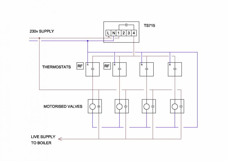

The red light will still work, but if you can hear a click, it sounds like it may be working (sorry for the pun) the only real way to know is to test it. If it is working then you need to find where the thermostats are getting their permanent live supply from.
Here's a diagram showing how I would expect your system to be wired assuming you have 4 motorised valves controlling it, the UFH may have different controls, but it shows the thermostat connections to the timeswitch.

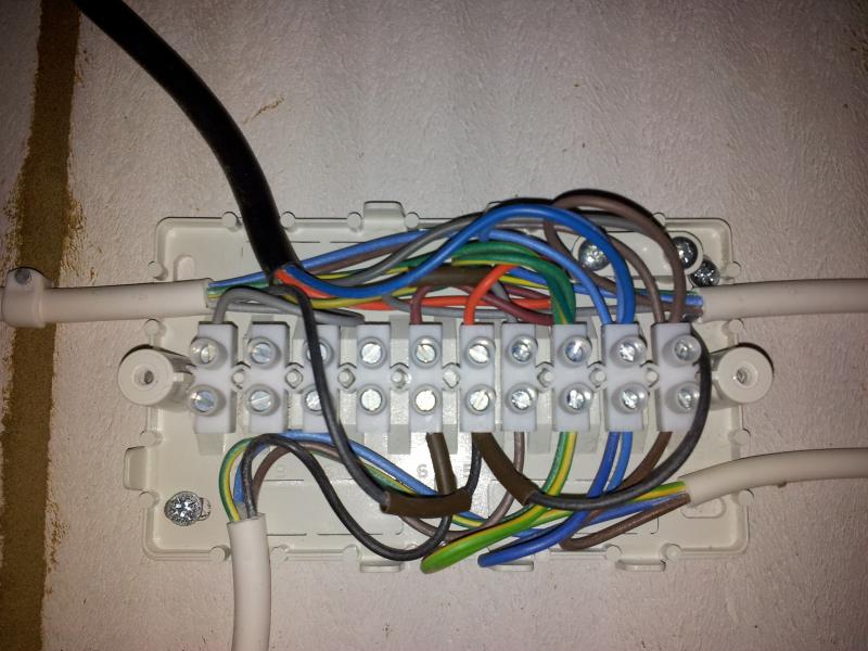

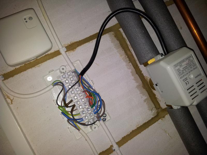

Thinking about it, I reckon the plumber has miss-wired a constant live to a switched live in the main junction block and bypassed the programmer. I can't think of a way of knowing whats what in the main junction block as it has mains in, wires to the boiler, wires to a valve, wires to the wireless honeywell unit and wires to what I guess is the downstairs stats. All too much for me, I might as well pay for someone to correct his bodge, if there is someone capable of sorting this mess out. I don't really have much faith left.....shame really because it is probably only down to one wire :eek:(
(photo on the left) Top left is to wireless honeywell upstairs stats, bottom left is mains in, bottom right is to programmer, black top right to actuator valve and white top right is to downstairs stats, i think?
Good photo of some messy wiring, but it's not possible to trace all of the wires visually. (For example, I can only see orange and blue wires from the motorised valve). I think you may have given the bottom two cables the wrong identities. It would be more usual for the mains supply to use a three core cable so that would be the bottom right one. If that is the case then it looks to me as if the mains supply goes straight to the upstairs and downstairs thermostats which would mean that they are permanently powered. Also the programmer would need four cores (unless it picks its main supply up straight from the FCU rather than the junction box)
Even if all the wires could be seen, the photo only gives half the story and we would also need one for each of the other ends of the cables.
I am also puzzled that there is only one motorised valve, when you have four zones. If there are others, there must also be some other junction boxes elsewhere.
Thanks Stem,
I think there are other valves directly under the programmer which are the under floor heating valves. The programmer and the under floor heating manifold is the other side of the wall of the photo and about two foot lower so maybe thats where the bottom cables head off to. I'll see if I can separate the cables for better viewing.
