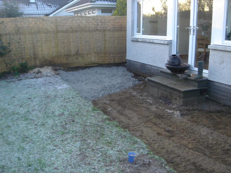

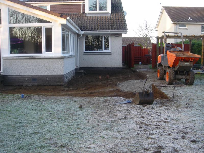

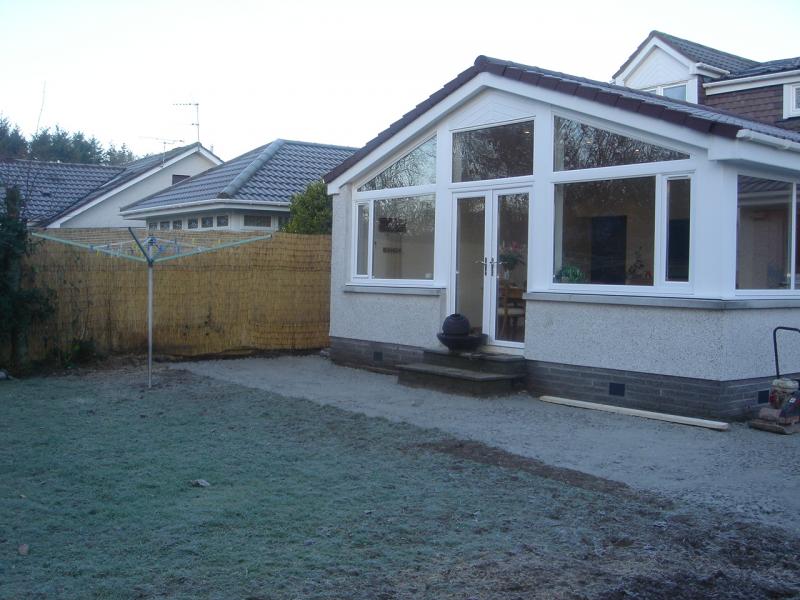

The jobs moved on and hardcore is in place and compacted. I have never seen this volume of earth dug out and basically i am in awe at these guys. To give some sense of the scale its 21 tonne of earth out and 18 tonne of hard core in. I am very glad i did not attempt this with my spade,shovel and wheelbarrow!
None the less its weird to have others on site and working while i am reduced to pottering(AND to add insult to injury i turn 40 on Saturday).
Anyway here's the latest photos and my wife has a whirly back after 15 months!(I did that bit you know)....... :)

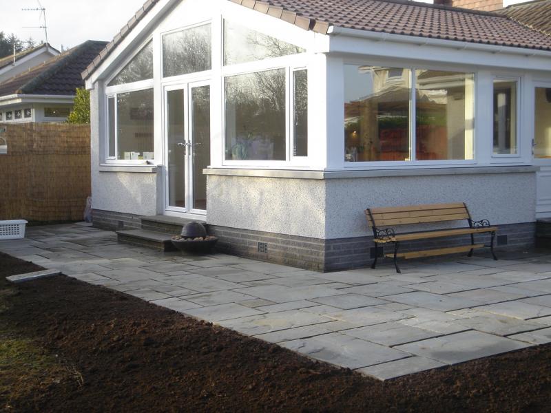

Hopefully the slabs will start going down today. It already feels luxurious to be walking on something permanant after all these months of walking on our eco friendly patio of old sarking and mud.

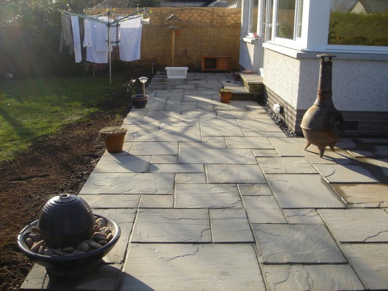

A bit for those that come after and are planning a patio....

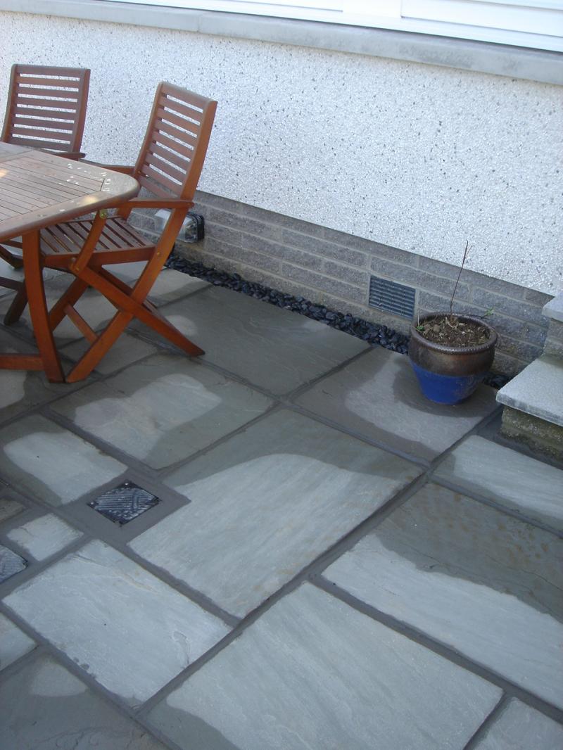

The patio slopes away from the house, there is a 100mm gap being left between the house structure and the start of the patio which will be gravel filled and the other edge at the grass will finish a slabs height(25 to 30mm) above the grass to stop grass creep onto the patio.

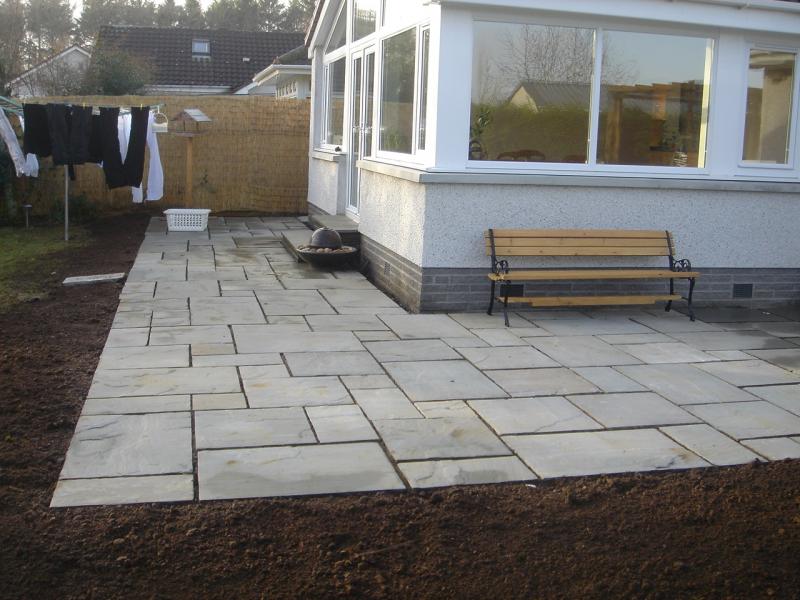

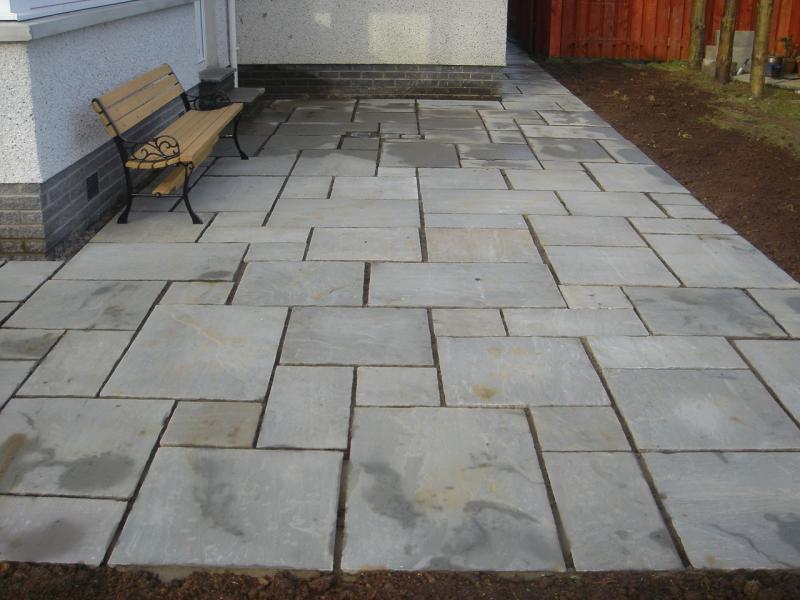

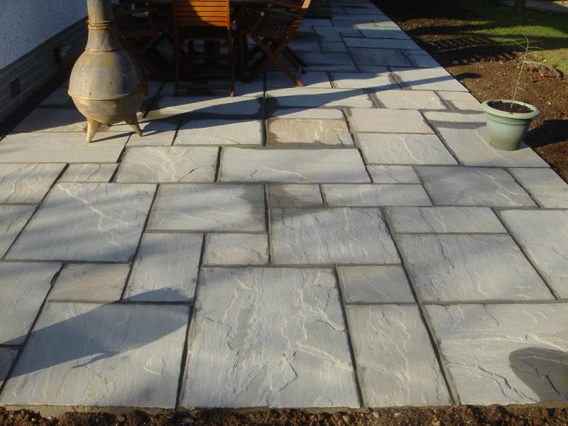

Its all over bar the pointing. That could not be done today as not totally dry here. Here's a few photos of the look so far.
I am extremely happy with the standard of work. I am now talking to a guy down in Cornwall about supplying the cedarwood hot tub. Need a fall back as the exchange rate for the dollar will not be in my favour for some time to come i think.
Finally got a bit of dry weather to get the pointing finished

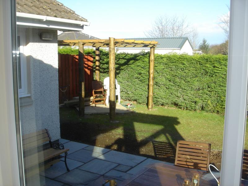

Laid chinese smooth black pebbles in the space tween slabs and house. Also ran in a couple of low level bulkhead lights with 60W energy saving light bulbs in them. I was very surprised at the price of outside lights. Most of the style i saw were nasty or making a statement so i went for the basic look.
A view of the pergola/hot tub site from the house, lots and lots to do!

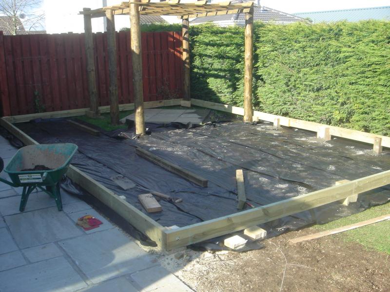

Well,
I've changed my mind again and decided to go for a softwood deck(correct me if i am wrong but is that not what most people on here go for)? .
My plan is for the deck to be 5m wide and 6m long. The 6m length will be projecting down the garden and encompass the pergola/tub area at the top end of the deck. After reading a bit on this and other sites i have came up with a plan. The deck is going to be single level and i'd like it to be as low as possible as it will be stepped onto directly from the patio to access the tub.
For foundations i plan to use 6" square posts cut down to 2' lengths, first thing will be the cut down posts soaking in a bucket of timber preserver for a couple of hours to allow the preserver to penetrate into the cut sections. I will then sink the posts approx 14" into the soil. The post holes will be belled out at the bottom to give a good anchor.A small layer of gravel will be put into each post hole to minimise post bottom contacting with earth.I planned on having the posts 1.5M seperation in any direction and expect to use about 20 to 25kgs of concrete per hole.
My frame joists would be 4"x2" and i was planning on them being set at 500mm centres with cross bracing dwangs same timber size at 1M centres.
My intention is to have the whole deck float on the 6" posts about 1" off ground. I will be putting down a weed membrane and holding it in place with gravel and plastic pins out round the edge.
To ensure i get 1" clearance off the ground(thinking air circulation) i will be sinking the outer frame posts first, building that frame and working my way in to the centre framing and posting as i go depending on circumstance. I will be leaving a couple of inches of excess height in the posts to allow for the required fall of the deck to ensure the rain runs off it. I also plan to rebate the posts and coachbolt the joists in place, this should give it some serious support!
Finally on the frame, once the frame is in place and post tops cut to flush i will be giving it a couple of coats of wood treatment on top of its exisitng treatment.
After that its decking time, the deck itself is 42mm thick direction will be from the pergola down the garden, stainless screws,straight lines and 4/5mm gaps are the order of the day?
The rests easy its just finishing details but i'd like any advice on glaring ommisions i may have made in my timber sizes, post spacings or foundation depths/shape. Same goes for any 'best product out there' timber treatments, deck oils or weed membranes.
Any advice much appreciated.

no need for stainless steel screws with softwood decking, normally only used for hardwood where it will be seen.
i would use 6 x 2 and the supports need to be at 400mm centres not 500
Thanks Thermo, does that mean that the s/s screws would penetrate the sonftwood deck and then get mostly concealed so go for standard deck screws?
I have seen a number of your threads on decks and a few of the photos. Like your style so 6 by 2 it is then. Going to stick to 500mm centres as the deck is 42mm(it might be 46mm can't check my sample as i am offshore the now) thick which is way over normal, i think that will offset any losses in rigidity over the extra 100mm tween joists. Or it could of course be that i find it easier to multiplty in 500's. I will do a bounce test once its under way and if there is any sign of bounce at 500 i will revert to your advice and go with 400. Thanks for the input.
yes the stainless steel ones will get lost in the softwood.
42mm thick, where have you got that from? thickest is normally 38mm, finished at 33mm
at that thickness 500mm will be fine. dont forget to put an extra bearer across where the length of plank will end. it saves a lot of cutting.
Its from a local sawmill(1 1/2 hours away from my house). Its the same place i went to for the timbers for the pergola. I am going up there next week with my mate in his van to buy a load. Do you want a sample? The guys are quite proud of the product. Its tannilised and available in various lengths. I think max length was 4.2 or 4.8Mtrs. I can confirm when i am there if you want.

Oh well, no worries on the foot switch. I made a start on the deck yesterday and today. Went to the sawmill for my pre ordered load and had to do 2 trips to get it all to the house. Bit of a bonus on the main deck foundation beams. Turned out the mill had a few surface split 7" beams so i bought them instead of 6" posts.
Jobs going as planned 25kgs concrete in each hole and all holes belled out at bottom. I have rebated the deck foundation beams so the outer frame is supported by the post and not the retaining screws and bolts. Everything else was bought through the bay and its all great fun !
The deck has turned out to be 7 metres by 5 metres which is a good size without being ott for the garden its in
A shot of how much is left of the post once rebated in 2 directions
Average depth of post in ground is 16", never sure how much to go to so i just go till hard ground and then bell out the hole
There's quite a fall running from the patio side of the deck to the other about 4" drop, luckily i overcut the height of the post so had plenty to play with
Only now in day 2 of 'Dawn of the deck' is it slowly dawning just how big a job it is! I think i am overengineering it but better that than the other way i suppose. :D
