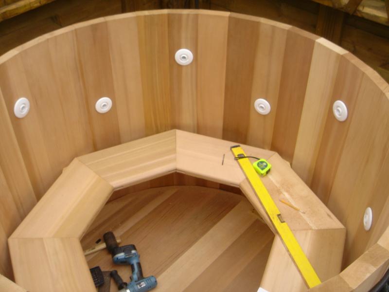

Support frame for bench going in and yes i am screwing into the tub wall to hold it up.
Bench comes in sections, up to individual how many sections they want at the order stage, well made and strong. Will be getting sanded down pre fill just to make sure no skelfs.
Screwing on the bench supports was nothing compared to the sheer terror of firing a holesaw through the side of my brand new virgin tub! :eek:
My hand was shaking so much i could barely make a pencil cross for the pilot hole!
Holesaw ran through from both sides to stop tearing of the timber

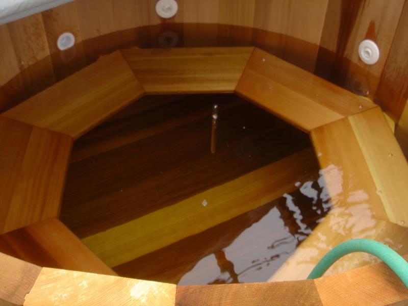

In the preorder stages i had to decide how many jets i wanted which led from what sort of visual finish i wanted. I.E how much of the tub did i want on show as the more jets you have the more piping so more of the tub is covered to hide the piping.....
Suctions fitted, the wee wooden brace is a assembly part and will be removed later.
Leaf skimmer to be connected to suction side

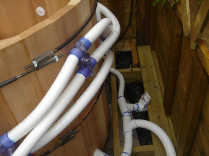

I noticed over the 3 years of dangerously obsessive but oh so enjoyable research that went before this that nobody shows the ugly side of their tubs in their pictures. I aim to change that, so here's mine! This will be the work area today, eventually all this side will be boxed in.
This picture pains me. If you screw your eyes up and look at it in a certain light it could be ready to use.......
More plumbing today and start to think about layout for pumps, heaters etc.

Had a good day. Plumbed the outside of the tub so i am ready to install the heaters pumps etc. This is still the ugly side of the tub!

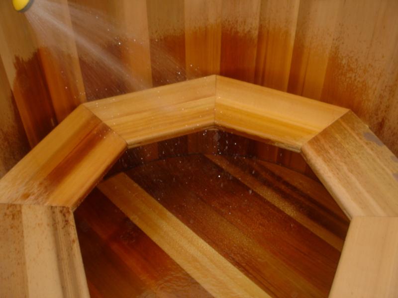

Once i had finished plumbing i decided to fill the tub to start the sealing process and leaching of tannins from the timber. Its pishing like a sieve at the moment but that's the way they are for a few days until the wood swells and completes the seal(alledgedly).

Oh yeah and the tubs still not completely swell sealed yet. :( Worried, who me?
Guesss the sealing process will vary depending on temperature etc
A quick ggogle turned this up - so could take a couple of weeks in theory
Why don’t cedar wood tubs leak?
Generally, they do – but only initially, after installation or if they have been allowed to dry out. During normal operation, when the wood is warm and saturated, the seal is made naturally (and without the use of any glue) as the wood swells by as much as 2% against the bands, making the tub watertight.
This process may take anything from a day to two or three weeks after commissioning, but we guarantee that they will always seal. The joints between each stave and the base are coopered to very fine tolerances by the manufacturers in Canada.

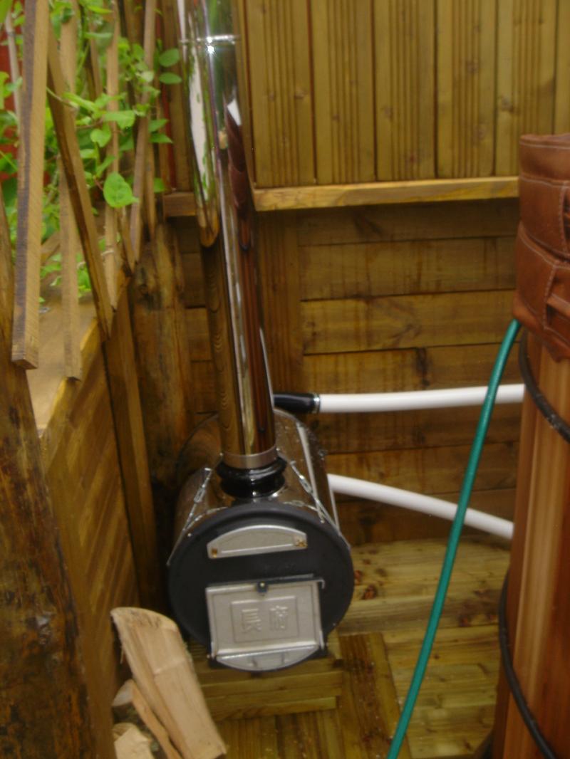

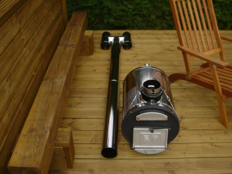

A couple of shots from today. Hooked up the Chofu and did a test burn to make sure it works ok. It went well, just did a burn for an hour without fully loading the chofu, got a 7 deg rise which is pretty good for a trial. Had a bit of a fright when hooking the chofu thru wall conns up as they were not long enough to go throught the whole wall thickness! Flash of inspiration and got the router out and rebated 12mm depth out for both fitting and all ok. Almost all leaks gone now, one more which is still dripping a bit but expect it to seal in the next couple of day. Hoping for the sparky next week. We'll see.
Tub filling up
Blurred shot of chofu exhaust
One of the thru wall fittings for the chofu that caused my heart to leap.
Squint shot of the chofu itself. Fire burns, water inside firebox jacket gets warm, starts to rise and pass through top pipe into tub whcih causes cold water to be drawn from tub through bottom pipe into water jacket.
I have carried out a real burn in the chofu today and temp went from 13 deg C to 38 deg C in 2 hours. Tubs still a soaking tub. I.E no jets so there is still a colder level at the bottom. Nonetheless we are continuing the burn, running out the 240 extension for the lights and firing up the candles for this evening. Bottle of Fleurie on stand by and first track will be shine on you crazy diamond. if you have to ask by who, well i feel sorry for you! :LOL:

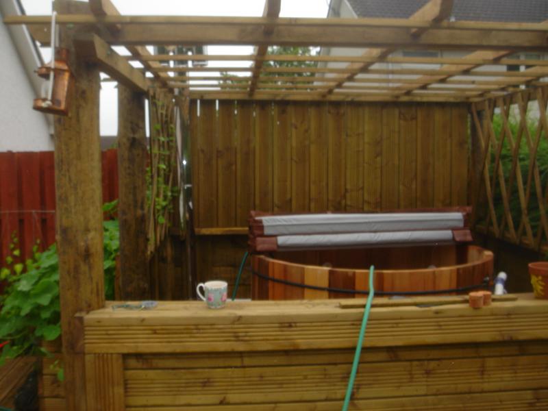

Also did a bit of work on the tub surround to house the pump etc.

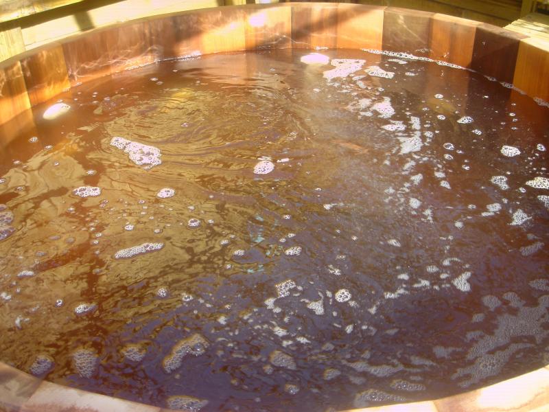

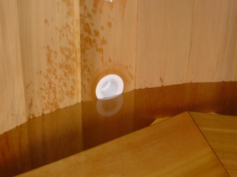

Final post for me on this project i think. All up and running now. Only issue and its a minor one is the tub internal light supplied was a 110V to 24V transformer. Its now a dead thing since we put 240 through it! No biggy will buy another next month. Maybe Almost heaven will send me a replacement?

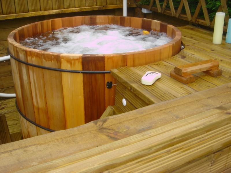

A few shots of the tub in action. Might post a couple of night shots as its nice with the candles and lights on.
Pump running at high speed, doesn't look much in the photo but it is!
Supercharged jets with air blower running
Couple of overall shots. Note the remote control. Huge range, controls the low and high speed of the pump and also the air blower. As i said previously we had to add some contactors to the system to enable the heater to be controlled from the remote. The heater now comes on automatically when the pump is running at low or high speed instead of being on a manual switch. The ionizer comes on when the pump is running at low speed. I have set the time to cycle the water for 20 minutes in the morning. Will be using it this weekend and then will start getting my head round water treatment. Don't think its going to be a biggy.
