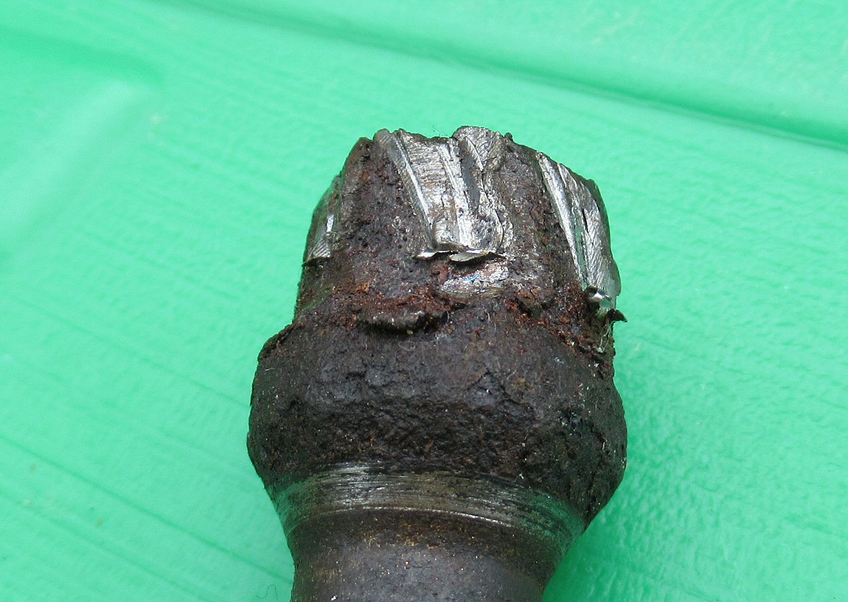

Rounded Wheel Nut
Unless you have a flat tyre, whiz it round to your nearest tyre shop and they’ll get it off for you.
that is probably the easiest solution so far - especially as I half know a few of them.
Anyway, got the extraction socket thing off my mate last night, so giving that a go is my first job the day.
that looks very corroded. are you in an area with lots of road salt? Looks like it seized onto the bevel on the wheel

digital image makes them look a bit worse than they are
17mm bolts is far too small for a wheel nut requiring 80lb foot

this wheel was fitted at tyre fitters last November when new tyres were fitted - they have a habit of putting them on too tight - seen them put them on with the air hammer then check they are tight enough with torque wrench, could be 100lb foot but as long as it clicks the torque at 80 they think they have done a good job.
Job done! Pleased you got it sorted.

What happens is the corrosion increases the pressure on the head of the bolt requiring more torque to remove it.
