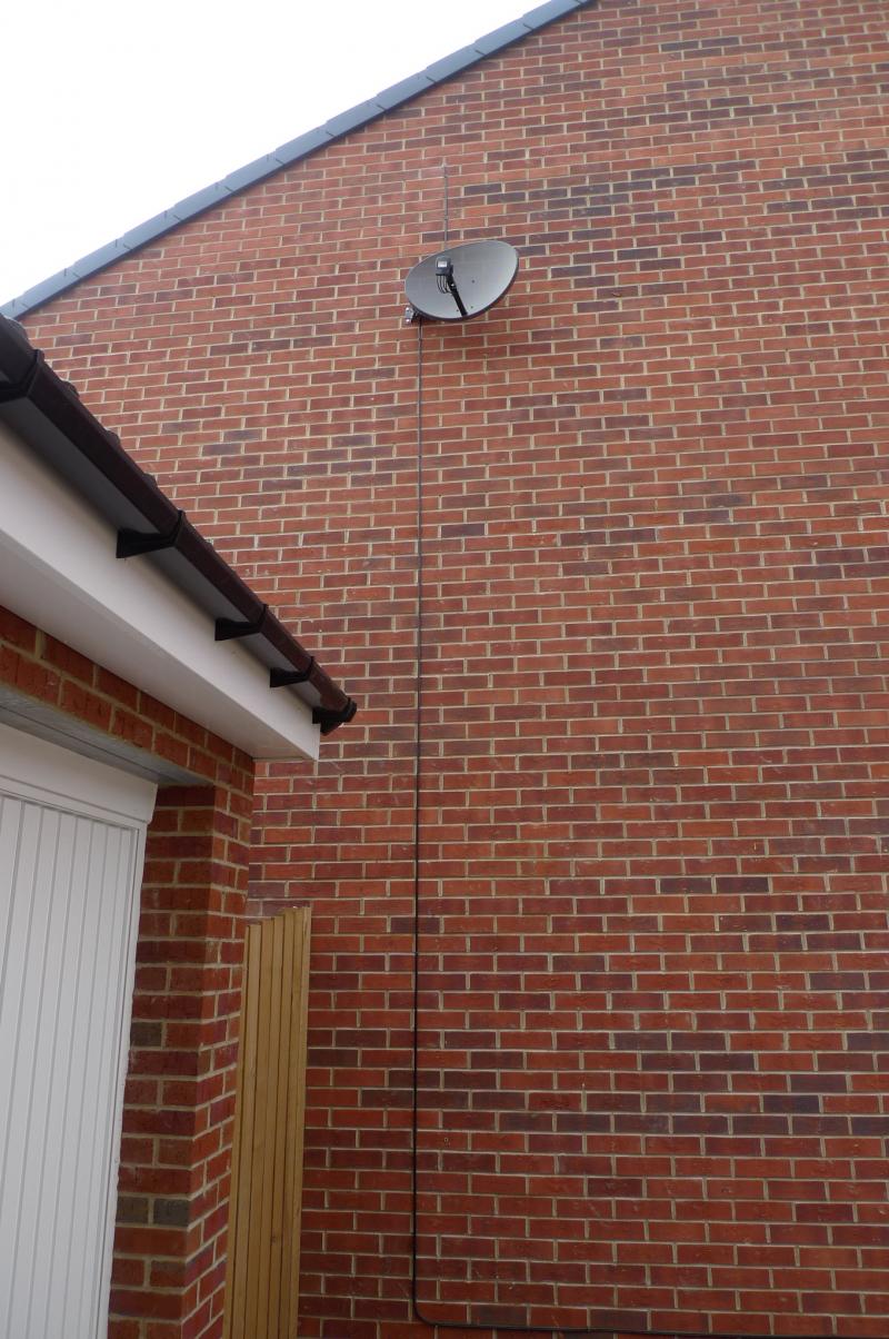

This is the current cabling setup of the Sky+ cables:
One cable goes up from the dish into the loft (and now down the wall into the bedroom) whilst the other cables goes down and along into the lounge behind the TV (just where I want the Cat6 to go).
Could I get some black outdoor Cat6, run it out of the loft through the same hole the top sky cable, run it along the same path as the other sky cable and into the lounge behind the TV?
I'm sure I could make it look neat enough on the outside...
you can do this, ive not had any problems with cat5 outdoors, i cant see a problem with ca6, i dont even think you need an outdoor type but someone may correct me
You can get black external Cat6, but far superior is duct grade. It is black with a tough sheath. It's perfect for clipping externally.

I'm thinking it's very unlikely to work, and the effort of crawling right out into the eve of the loft to try it already nudging me towards the outdoor cat6
