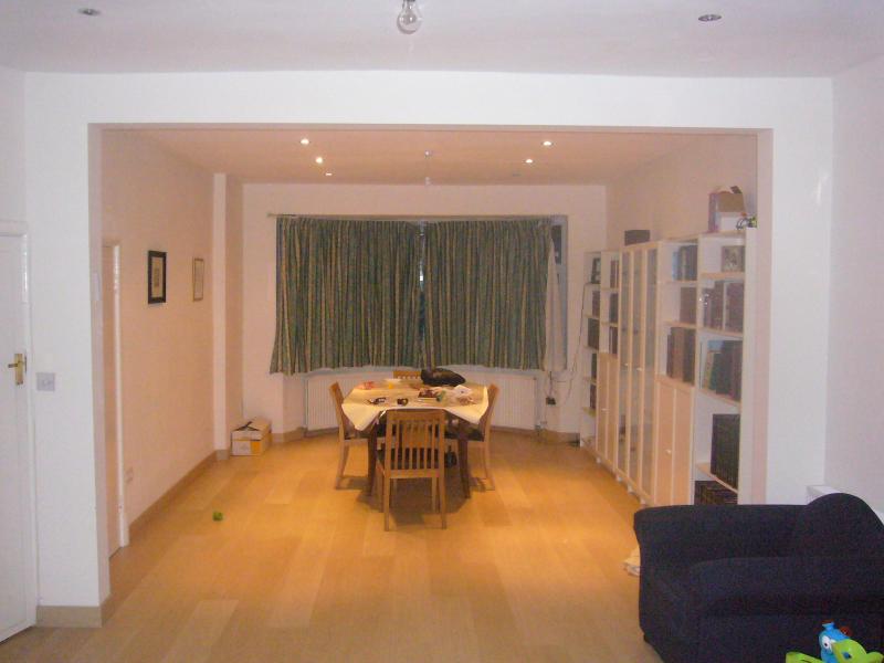

RSJ installed badly? - Please comment on photos
Surly there is adequate foundations as from looking at that photo i think there used to be a wall there where mr builder nocked a great hole through, then placed in a steel to support the upper floor.
Yeah, but if the footing are shallow (250mm or less in old houses) the load isn't going to spread far back along the existing footing, so is concentrated on the ends. Sometimes a stiff base beam is put in below floor level to spread the load back along the existing footing.

Don't know if this matters at all, but here's a pic of the finished job (as it currently looks).
Measurements (if they help?) are:
Pillar width @ 30 cm
Pillar depth @ 19 cm
Total width 390 cm
. I'd like to think he actually used a competent SE, but really can't be sure. Seems I have no choice but to expose and get a new SE in (as well as BC).

Nine times out of ten everything will be fine and if you choose to leave everything as it is, that's up to you...can imagine you're not keen on knocking your wall about again if it's all decorated and furnished...
But if you do choose not to do anything, there might be a risk of settlement of the footings, possible cracking, and issues if you sell.

OK, what is the downstand from ceiling to bottom of beam?
Is the wall above masonry?
Do the floor and loft joists span onto the wall?
Any roof load to the wall?
If 19cm sounds like room for a 152x152 UC...
