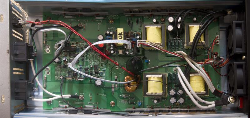

Thank you for your thoughts. We have been given permission to open the inverter to test it. There is an array of FET's and car type 16A fuses one for each FET and it seems one FET may have failed and blow the fuse and the others would continue to work.
However once that has happened the there is a chance of overheating since the safety devices are set for when all FET's are working.
The first time it went it was after plugging in a kettle i.e. pure resistive load but at the time we did not realise anything had blown. Hind sight is good and we now realise that's why it would not run the washing machine when fitted because some of the fuses had already blown. However at the time we though the fault was the battery isolator and did not realise the inverter had been damaged.
If we could return the inverter to a shop it would be easy but the last time it was returned it cost two thirds the new price of the inverter so we must consider very carefully if returning the inverter is worth while or are we just wasting money.
Frankly that looks a little.. well, shall we say pathetically small for 3kW? Doesn't look much bigger than my 150W inverter, and if those little metal places are all the heatsink it has..
With the problems you have had with the inverter, it could be time to cut your losses and get another inverter which is actually up to the job.
The one you have clearly has major problems and even if it can be made to work, how long before it fails again?
Xantrex mentioned already, or Victron Energy.
Obviously not cheap options, but then neither is paying out 100s every time the existing one melts.
I would have thought that if you can show that it won't supply a steady-state load of 3kW indefinitely that you've got excellent grounds for a full refund of all purchase, repair and shipping costs.
