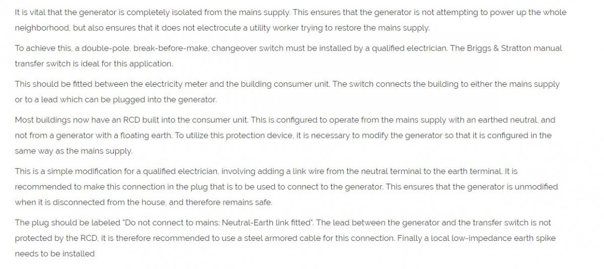

i found this before sounds familiar

In the past I have had generators where the earth connection is not bonded to either supply line, be it an IT arrangement or bonded to some mid point between the line 1 and line 2. In essence it does not have a neutral but line 1 and line 2.
The problem is should anyone try bonding a line to earth to produce a neutral where the is also a bond to some other point it can produce a dead short, as a result one needs to do some very careful testing before you bond any line to earth.
As already stated you should have been left some paperwork showing what has been done, without that some one will need to very carefully follow the wiring and test to find out what is in place, it may be the neutral is bonded to earth at the wrong point, or a double pole switch has a welded contact or even wrong type of RCD. However it is not something which can really be sorted on a forum, you need some one there on site to sort it.
