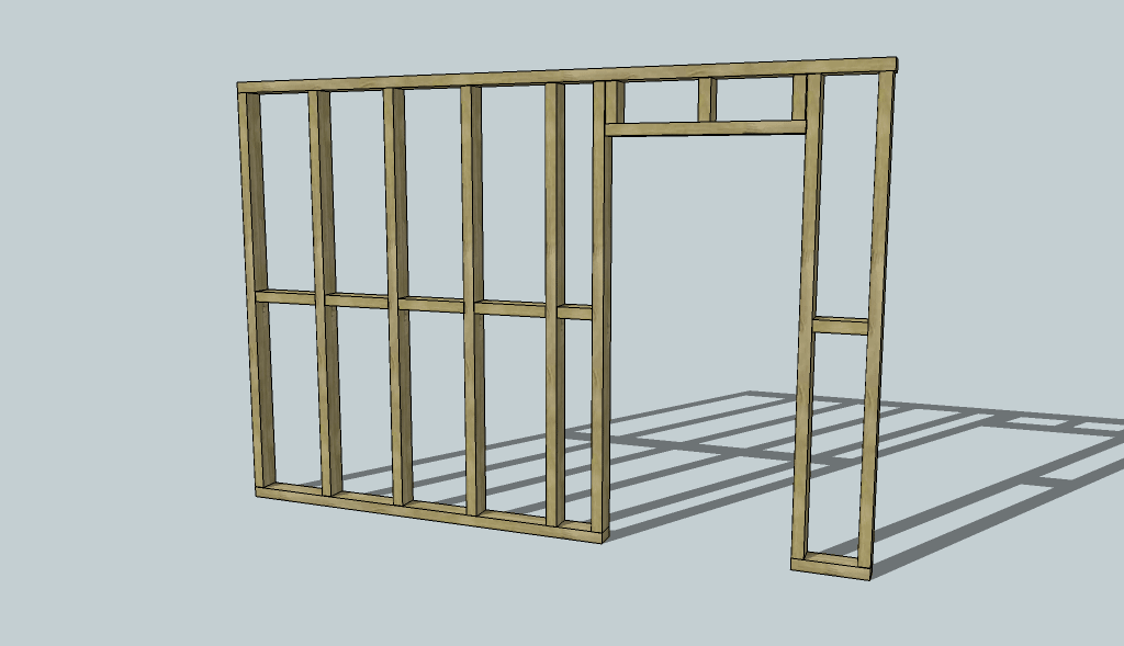

Indeed one of the soil pipe runs behind the kitchen and if I remove the kick boards I can see the pipe - the plasterwall behind the kitchen was left a little unfinished. My question is what do I do next. I need that cable in the living room which is by the kitchen. The soil pipe ends up in the common corner so I could easily make a hole and run the cable from that corner into the living room but I need it at the other corner of the room. Are you saying that I should expect horizontal noggins and not vertical? I thought the wall was built as in the picture below.

If you are unlucky enough to live in a house with metal stud work they also have no horizontal noggins.

Where I come from houses are all bricks and blocks and we use corrugated hoses to fit all the cabling. If your cable fit one of the existing hoses, happy days (ok, Ethernet should not go with mains but it could be an acceptable compromise). If not - or if you want the cable where no existing sockets are installed - then the only solution is hammer and chisel. I now understand that in a timber frame house there are many "it depends" situations. Maybe I shall hire a stud finder to find out whether my original plan could work or whether running the cable down the soul pipe would allow me to then run the cable more close to the opposite corner of the room.
They'll also take some drilling now they've been built around. I hate drilling those things, particularly when the chippies have filled the horizontal piece across the top with wood. Killed off two expensive holesaws drilling that stuff recently. Ugh.

Sometimes it's hard, often it means making a mess and repairing it. Getting up the walls may mean making holes in the plasterboard to drill the noggins and soleplate etc - or with brick/block walls, chiselling out a chase to put a conduit in. Then to get around a floor the "tried and tested" technique is to lift a few floorboards and fishing the cable either along the space between the joists or through holes drilled in the joists**.
