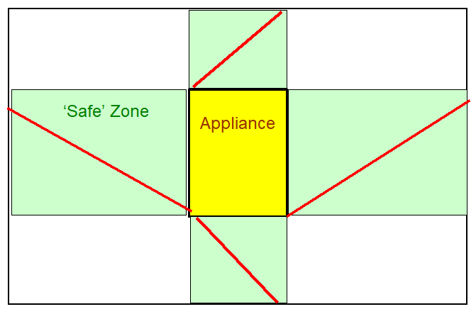

As to original question, if the whole appliance defines the zone, wires still need to run straight not diagonal, and one would not want to remove the wiring when ever the appliance is removed, so in real terms it would be the outlet which defines the zone.
Why? One is surely free to route cables however one likes within a defined ('safe') zone, isn't one? If that zone is very large, then the cable could surely be 'diagonal'?
We are used to pretty narrow zones (usually the width or height of an accessory's faceplate), which means that cables have to run roughly vertically or horizontally, but that all changes if the zones are very wide.
...but, as had been discussed, what do you mean by ';the outlet' - and, in any event,that 'point' becomes useless as a guide to someone with a drill in their hand if it cannot be seen because it is hidden somewhere behind the appliance.
Why? One is surely free to route cables however one likes within a defined ('safe') zone, isn't one? If that zone is very large, then the cable could surely be 'diagonal'? .... We are used to pretty narrow zones (usually the width or height of an accessory's faceplate), which means that cables have to run roughly vertically or horizontally, but that all changes if the zones are very wide.
In case my prose explanation was not adequate, IF (which I seriously doubt was the intended interpretation of the reg), the entirety of a large current-using-appliance defined the ('safe') zones, then cable routes such as those shown here in red would presumably be perfectly compliant with the reg ...

Indeed it won't - but if one has a rough idea of the size and position that the appliance will have, one could identify areas which would definitely be within those zones
