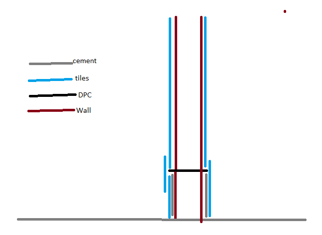

Thanks - can you help with this though. If i want to tile the wall (and will stop just above the dpc so as not to bridge it - 5mm above ok?) can i then install a tile 'skirting board' ? I could attach it to the bricks below the dpc with s&c then tile adhesive - ensuring i leave a gap under the dpc, then the top of the tile would lap over the wall tiles - i could stick the top part of the skirting tile on with silicone to the wall tiles? Would that bridge the dpc - porcelain tiles.
Have i even explained that in a way that can be understood?! I can draw a sketch?

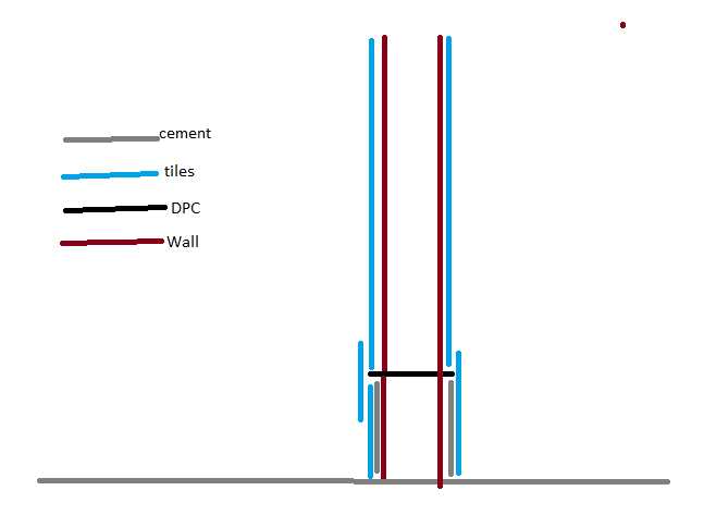

Right or left?
I suppose the one on the left is better as there is a cavity.
I would think so if the gaps there, and perhaps off the floor? Not sure about that bit. Moisture would have to wick into cement then through tile. Hard to see it causing an issue.
