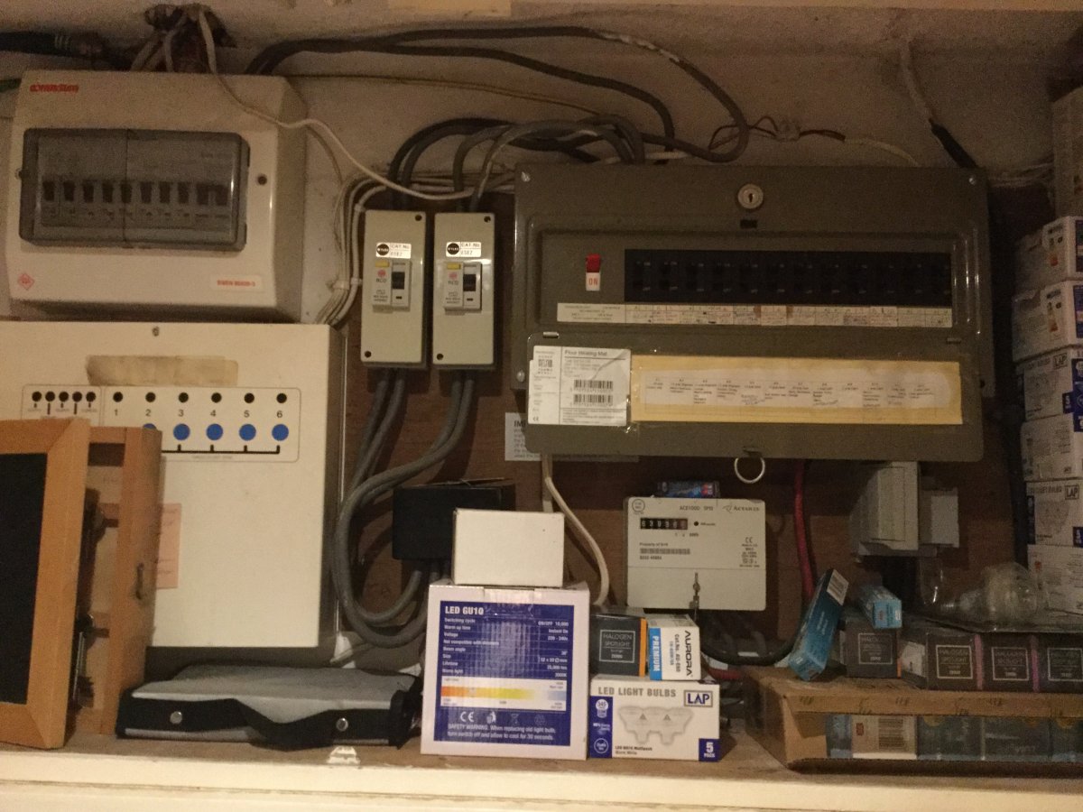

1/ why do I think I need a new consumer unit ? See photo - ignore the alarm panel on left hand side its not connected. So you see the issue .....
2/ why did i request the tails to be changed ? i didnt I had to Google it to find out what this meant I dont know if this is necessary work.
3/ the advice was as a first step install new consumer unit and test the circuits. -this was what the quote was for and did not include any other time/materials in resolving any issues which may be thrown up

You have RCDs and you have MCBs.
It's a bit untidy but if I were you I'd keep your money for the time being.
Save the money to put towards a rewire in the future.
Or if you want to be sure, have an EICR done, and then have anything that's flagged up as a C1 or C2 remedied. Don't believe anyone that says you need your CU upgraded to meet ammendment 3 standards, as you don't.

The consumer unit at top left hand side of picture feeds
  • External workshop with its own consumer unit with MCBs
  • external office which has its own consumer unit
  • External power to pond pumps and lights
The right hand side consumer unit feeds the orginal house and multiple extensions therein
