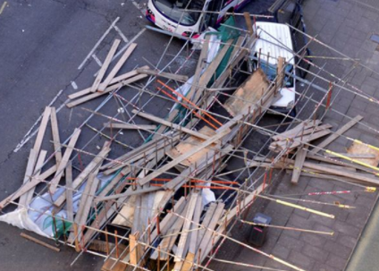

failing that I have some you can have, collection only, one careful owner:
Looks good that, looks like you've got it stored away neatly too :D
