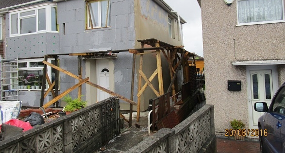

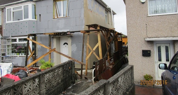

Last time I needed a portable way to get high enough I built a scaffolding tower out of some scrap timber, it was light enough so I was able to just slide it around, rendered/painted a 2 story building in no time. After that I used the timber to make something else.. Took no time to build it, didn't had to go anywhere to get one and the only cost was in screws...
Is this it? £1.99 +free p&p off eBay.
