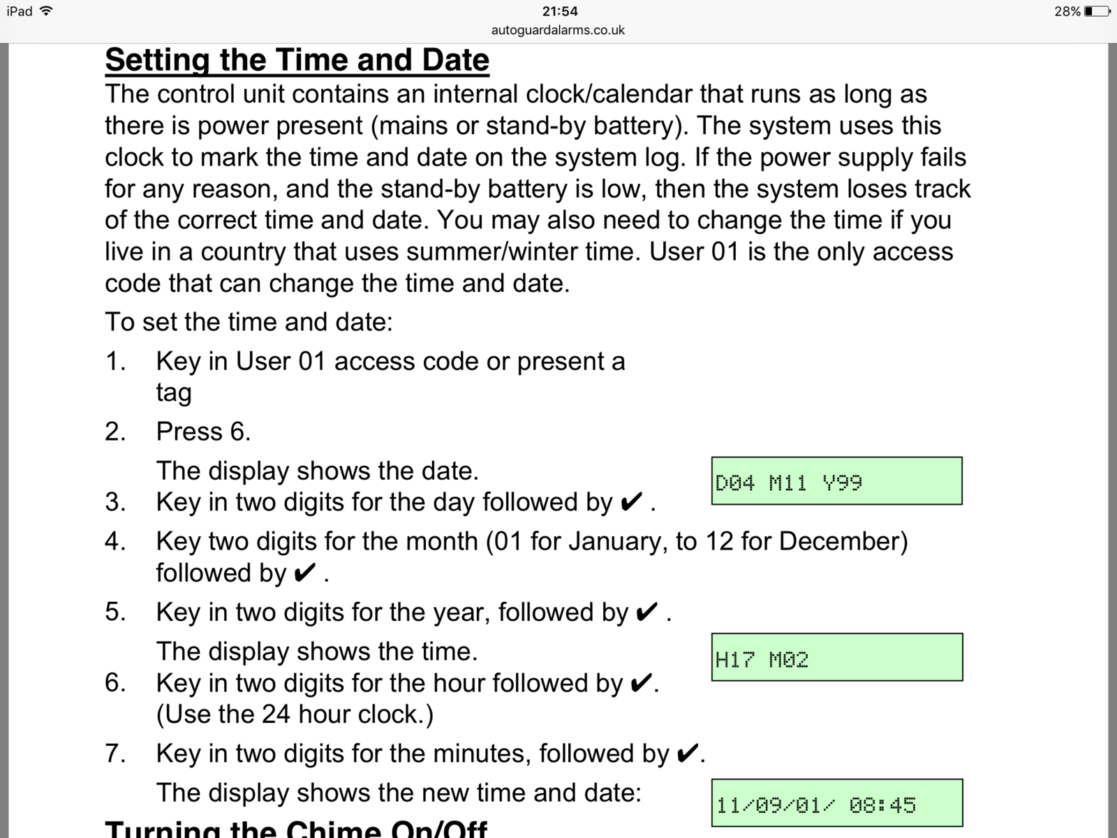

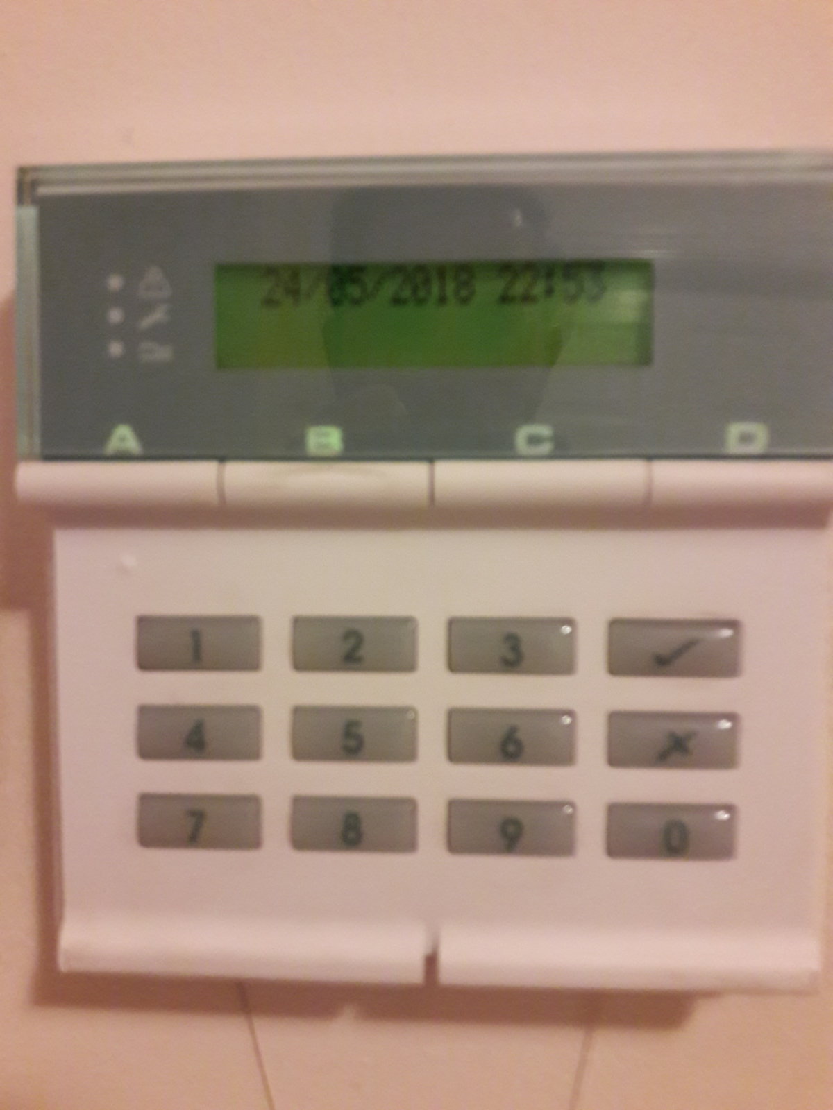

Set and unset ok all good apart from the time.
Battery had 2006 date on it!!
