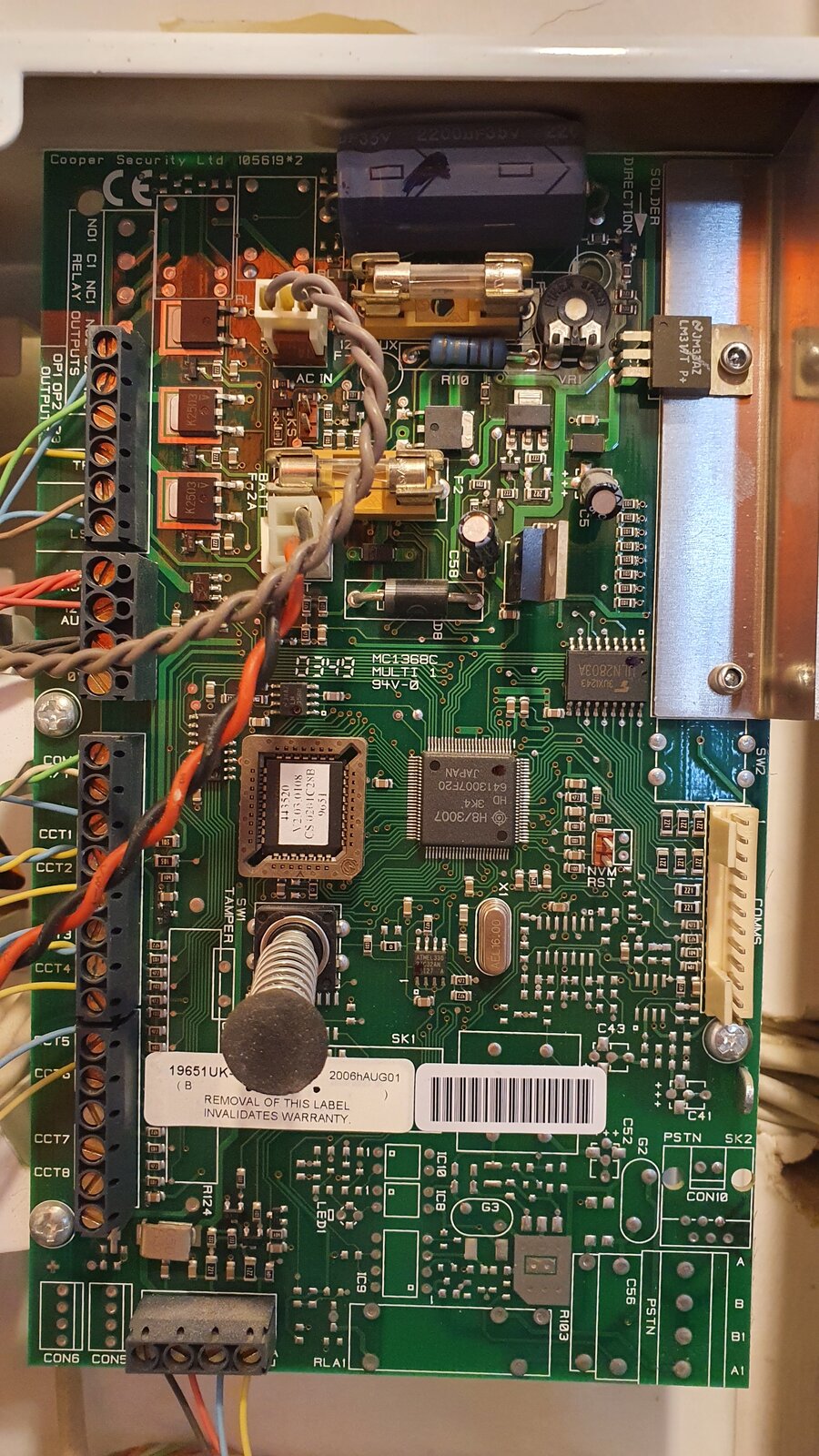

Check battery leads are connected correctly.
Not uncommon that new battery is totally flat and control panel will not charge battery.

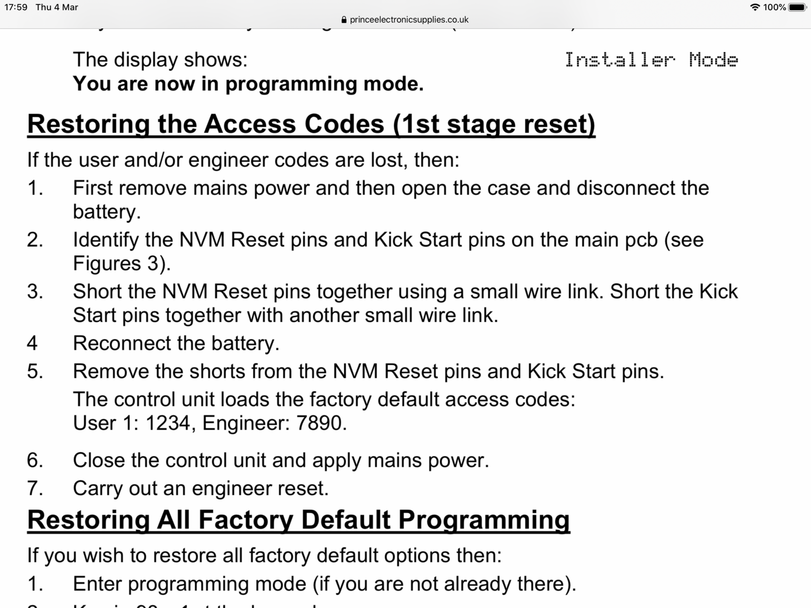

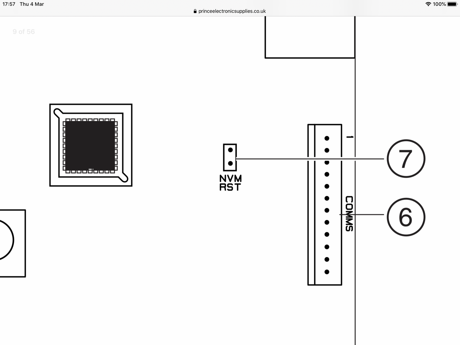

I can see the NVM pins, no problem, but are the Kick Start pins the box marked 6 on diagram 3 that you uploaded before?

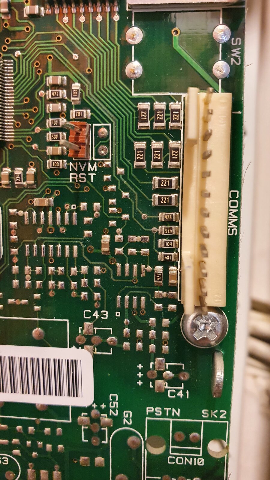

Is it the Comms pins? If so which of them do i short, there's 12 pins?

Power down system
Short NVM RST pins with small screwdriver, power system back up with pins still shortedthen remove short.
Now do a stage 1 reset as described in manual.
This will reset engineer code and user code back to factory default. All zone programming will remain with stage 1 reset.
There is no need to short the kick start pins.
