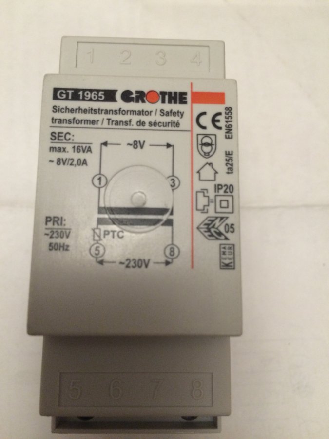

I have finally got the Byron transformer. Attached are the pics. The paperwork says 8v 1a but the transformer has 8v 2a !
I assume I connect the same way as I tried before.
