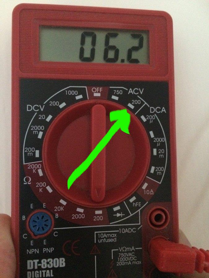

Put your multimeter across the transformer set to AC VOLTS.
What voltage is shown

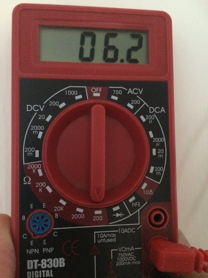

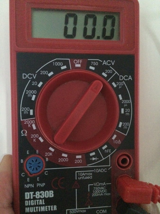

Here is a pic. It's the same reading on both chimes. When the button is pressed down, the reading drops to 0 and then back up to 15 when button is released.
Sounds like you was measuring across the 2 wires to the bell push, instead of the two left hand terminals, test voltage at the 2 left points shown in freddos picture
Here's the output I think it's the right setting without button pressed. When it's pressed the reading goes up and down so didn't take a pic of that. Unless I have the setting wrong on multi meter?
Unpressed ...

So………….. 10.3v is that without the button pressed?
if so
what is the reading when the button is pressed??
