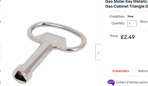

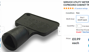

As I said,it's better than nothing, but obviously no significant impediment to someone who wants to open the door/whatever.
Such a lock is an extremely standard device on electrical cupboards and cabinets.
It is, and the key is also a device which is very widely available at minimal cost ..
As a contractor I find them (or similar but with different shapes) frequently being used for such a purpose. The big advantage of the three square is meter readers use them all day long.
Yep, if one wants 'different shapes' (maybe to allow one to widen the scope of one's 'malicious activities'? :) ), one doesn't have to pay any more ...
