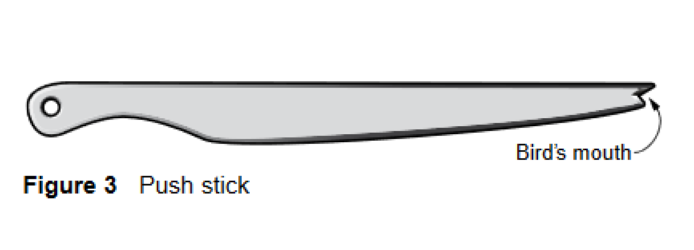

Your man is also working with a fully exposed blade and no riving knife. See WIS 16, again :rolleyes:
He pushes the work past the exposed blade using a mickey-mouse push block - you really should always keep your hands at least 16in/400mm away from the blade, with a properly designed push stick. one like this (see WIS 16...):
There is also a limit to the length of timber that jig will actually accommodate.
