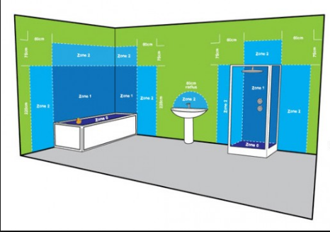

I have looked again at the zones.
They measure floor to ceiling (obviously ridiculous) yet when it comes to the sink they specifiy a radius around the taps.
Now that actually makes sense.
If you have no shower above a bath why does zone 1 stretch to to 2250mm??
Think for yourself and ask questions, you will learn more that way.
I have looked again at the zones. They measure floor to ceiling (obviously ridiculous) yet when it comes to the sink they specifiy a radius around the taps. Now that actually makes sense.
It might 'make sense' but, unfortunately, you must be looking at a very old description of bathroom zones, because a basin has not created any zone (does that make sense?:) ) for a a long time!
Kind Regards, John
I would point out that the shaded area is not a radius - so, doubly wrong.
I presume that the "radius" is intended to refer to the radius of the curved corners at the top of the zone around the basin which they have invented (or resurrected from some grave).
Kind Regards, John
Well, as it's wrong, it's not worth discussing.
Here's another which makes up additional areas:
Correct, any part of a circle is the radius.
Well, another thing learnt. No zone around basin taps but a huge zone around bath taps?
Perhaps the 'inventors' of these regs expect amorous shenanigans when bathing!!
Well, another thing learnt. No zone around basin taps but a huge zone around bath taps? Perhaps the 'inventors' of these regs expect amorous shenanigans when bathing!!
To be fair, there is not a zone around bath taps, per se - rather, a zone around the bath or shower tray. One imagines the reason for them is that they are two places where naked people commonly stand in, or are submerged in, water.
If it was felt necessary for special consideration to be given to areas around bathroom basin taps, the same would presumably apply to taps in kitchens, utility rooms, taps in basins of 'toilet rooms', not to mention bidets etc. etc.
To be honest, the bathroom zones have increasingly less relevance. A high, and increasing, proportion of domestic bathrooms satisfy the requirements for omission of supplementary bonding, so about the only other current relevance is that new work within the zones is notifiable.
Kind Regards, John
Hear hear
So work outside the zones is non notifiable? As in putting my shaver socket nowhere near the bath.

Yep, even ceiling lighting, provided that the ceiling is more than 2.25m 'above finished floor level'. New showers are the main thing which cannot avoid being notifiable, since they are (more-or-less) inevitably in Zone 1 (and often involve installation of a new circuit)

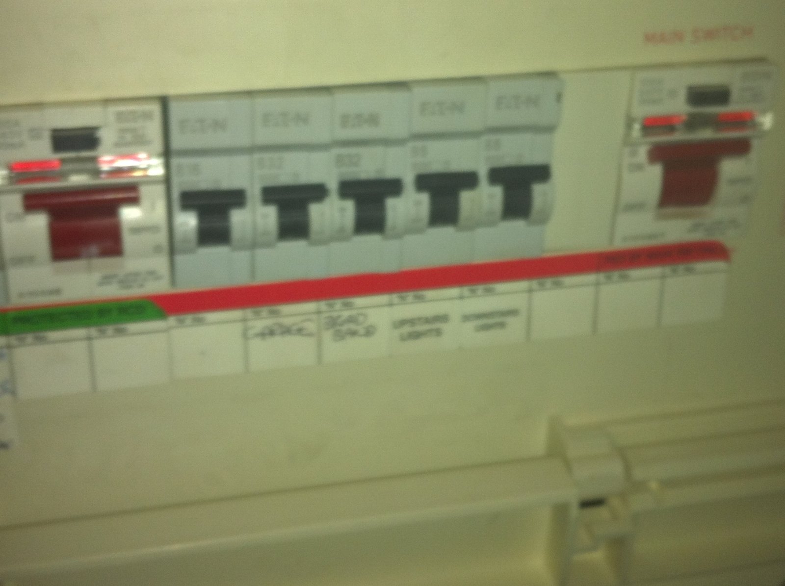

I have also included a picture of my fuse board. I'm trying to get my fiver back. Is that not RCD protected? (last gasp hope):)
