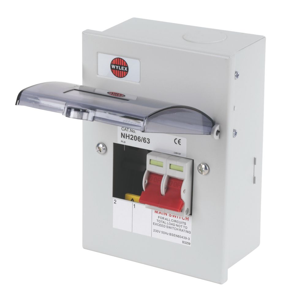

Personally I would use a metal consumer unit in a shed as easier to fit the SWA gland into. These from Screwfix may need a RCD or RCBO adding but it seems you will latter be able to swap front plates to make them amendment 3 compliant and easy to fit a SWA gland into.
(here goes the disclaimer so hopefully i can get an answer) just to satisfy my curiosity and to perhaps learn somthing, as i wont be designing this.
I can see why you suggest a metal CU when fitting a CU in the shed, would it be possible instead to fix the armored cable in to an intermediate metal box before the CU which would take the strain of the cable, and then a small none armoured run from there to CU? or would this be bad practice, if so, why?
thanks
That's fine, but generally a way round the problem when there's already a plastic CU in place. Starting from scratch it would be better to avoid the problem by not installing a new plastic one.
