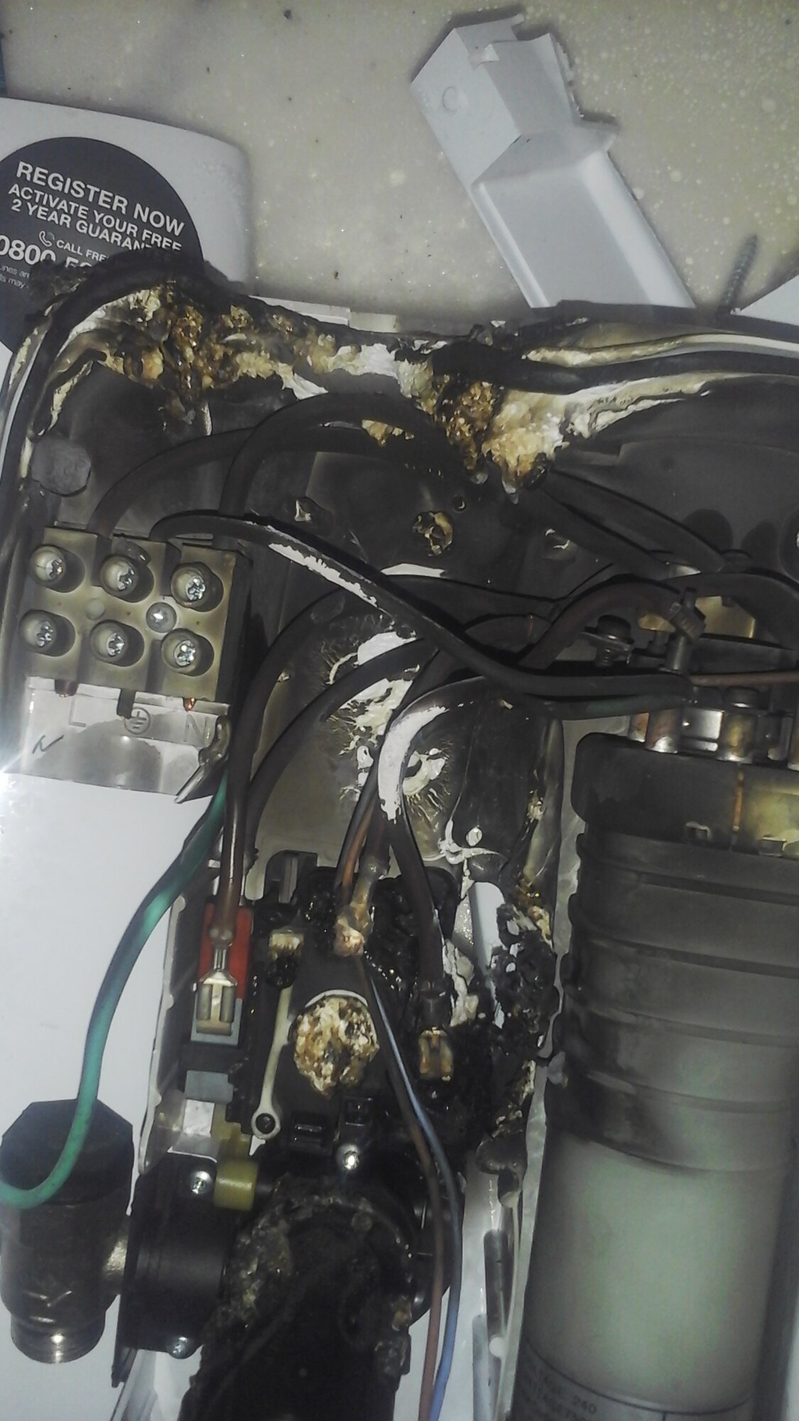

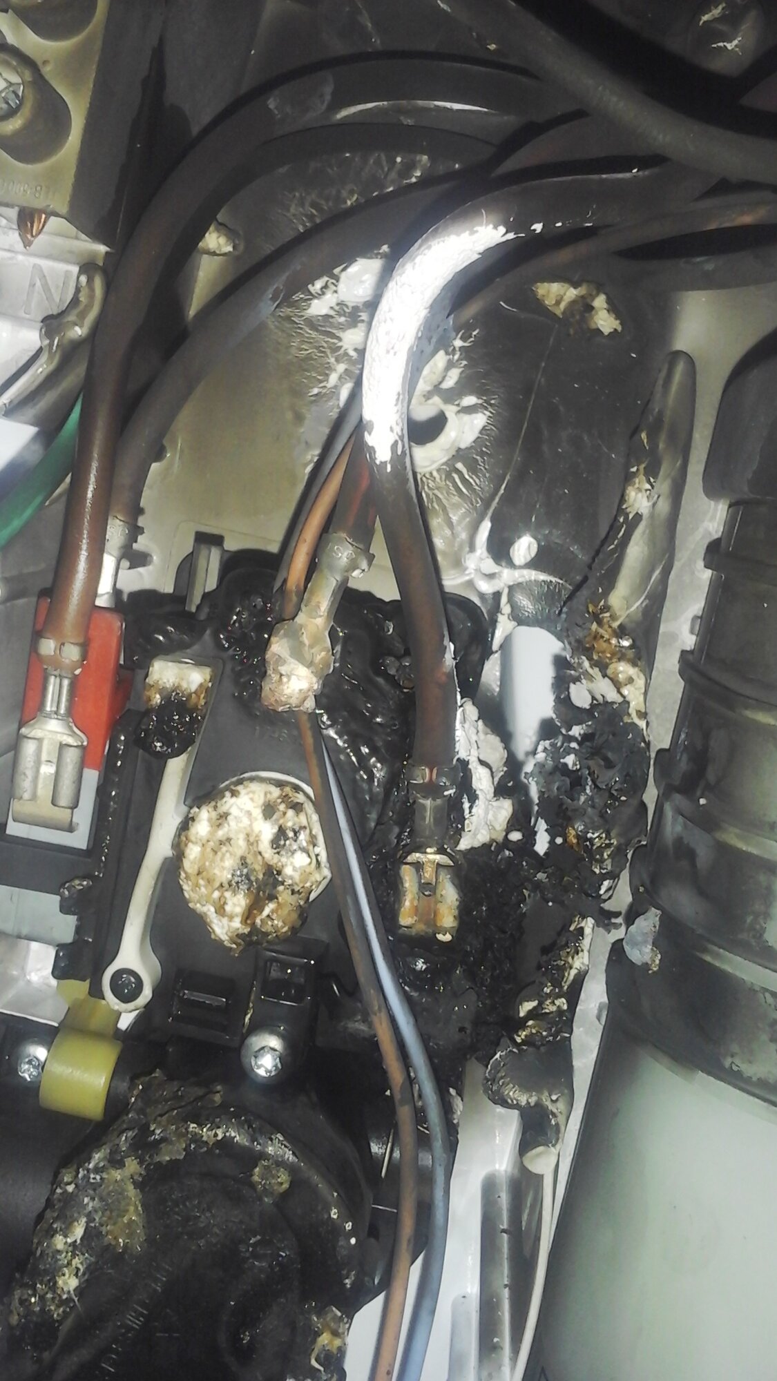

Shower fire
At least you got the 2 year guarantee!
Is this by any chance a recalled unit?
It was a job at work not my house, so i dont know, will look into it
Looks like one of the micro switches has not fully opened when the shower was switched off and has been arcing internally until it got hot enough to go on fire.

You would use the local isolator to switch off your now on fire shower in an emergency. Well you would if some idiot hadn’t told you that you don’t need an isolator.

To play devil's advocate to some extent (who, me? :) ) ...
.... I don't know how commonly (if at all) they actually cause (house) fires (the U-F material they're usually made of is pretty 'non-combustible') but the impression I get is that at least 'burned wires' are far more common in shower isolators than in showers themselves, aren't they? [and I actually suspect that even a 'shower on fire' would usually be unlikley to cause a 'house fire']
