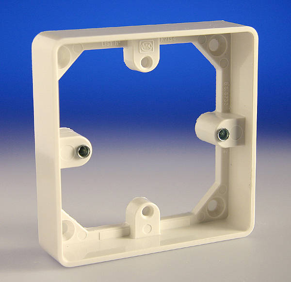

I dislike those pull cord isolators they are often a bit difficult to get a 10mm cable in the terminals and then push back into & screw into place. The crabtree version is better but looks a bit sh1t. I'd much rather use a rotary version in a cupboard or something similar. I'd always have an isolator though!
One of my 'trademarks' is cut a hole in the ceiling for a plasterboard box and in the back of an adaptable box (I prefer a 6x4x4"), place it on top of the ceiling so the holes line up, remove the back from a plasterboard box and fit. I then have a big box to take the large cables with a lot more ease than a patress box.
I've seen something similar done with these devices:
But I've usually seen them when I make the repairs.
