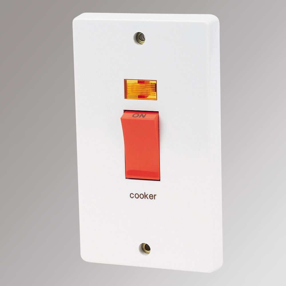

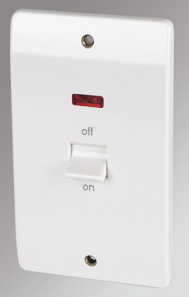

It seems to me that the bog standard square pull switches for showers fail a lot more often than a round Crabtree 50amp pull switch, or most types of 45 or 50 amp wall switches.
I try to use 50amp Crabtree stuff wherever possible for showers,
Hi, I prefer a 2 gang switch switch, a bit more space to manoeuvre the cables, and as sparkwright mentions, Crabtree are quality.
