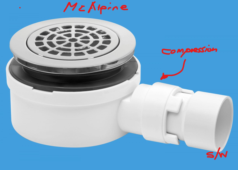

Thanks, looks good. But I already had an alternative freebie supplied with the shower tray and put that aside for this McAlpine because it was deemed better by the trade guys. It has a very low, flush grille that doesn't protrude and get trodden on or tripped over. My trap grille is just inside the shower door, not at the back. Thanks for the tip, I'll look more at similar ones.

There is a very good discussion on this solvent weld trap dilemma here.
https://community.screwfix.com/threads/solvent-weld-shower-trap.76530/
And as pointed out there, nobody seems to know of a completely S/W trap that doesn't have at least the final connection as compression, although in the case of the McAlpine (photo below) it is a square section rubber seal with a hard location on a shoulder, not the tapered section type that slide along into position.
This is the same as the trap that I already have, but with the swivel elbow double compression replaced in this S/W version with a S/W socket, but still with the final joint in compression.
>> It looks like with all the best will, it will always be at least the last joint in compression.
> I'm always open to any further updates.
Thanks everyone
You really are overthinking this. Good quality compression waste fittings are perfectly fine in this situation.
