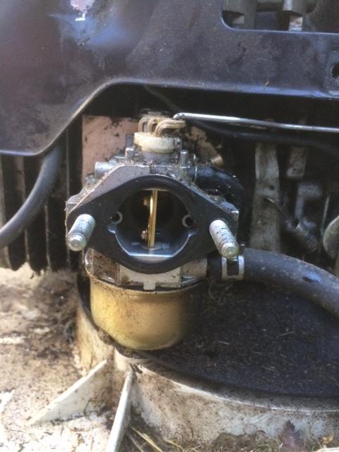

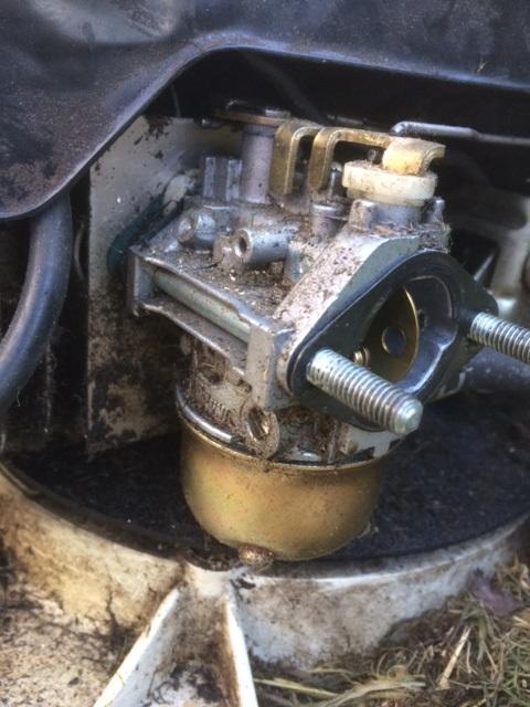

This is the carburetor;
Any suggestions appreciated!

No pump diaphragm on that one, but its dead simple to strip the carb for a clean....removing the float bowl wil likely reveal and rust particles or previous water ingress.
John :)

Cheers John - I'll give it a strip and attack it with my air gun :)
Good idea....release the carb from its bolts, this will allow you to disconnect the linkage rods.
After that, its float bowl off, release the float from its pin (the needle valve is captive to a degree) and unscrew the central main jet.
Above that is an emulsion tube which usually falls down - it has several tiny drillings that must be clear.
The pilot jet for slow running maybe accessible below a screw on the top of the carb, depending on the age....anyway, the air feeds to this are the small drillings separate from the main choke - visible in the lower pic.
Some aerosol carb cleaner is very useful for cleaning these out!
Be lucky
John :)
