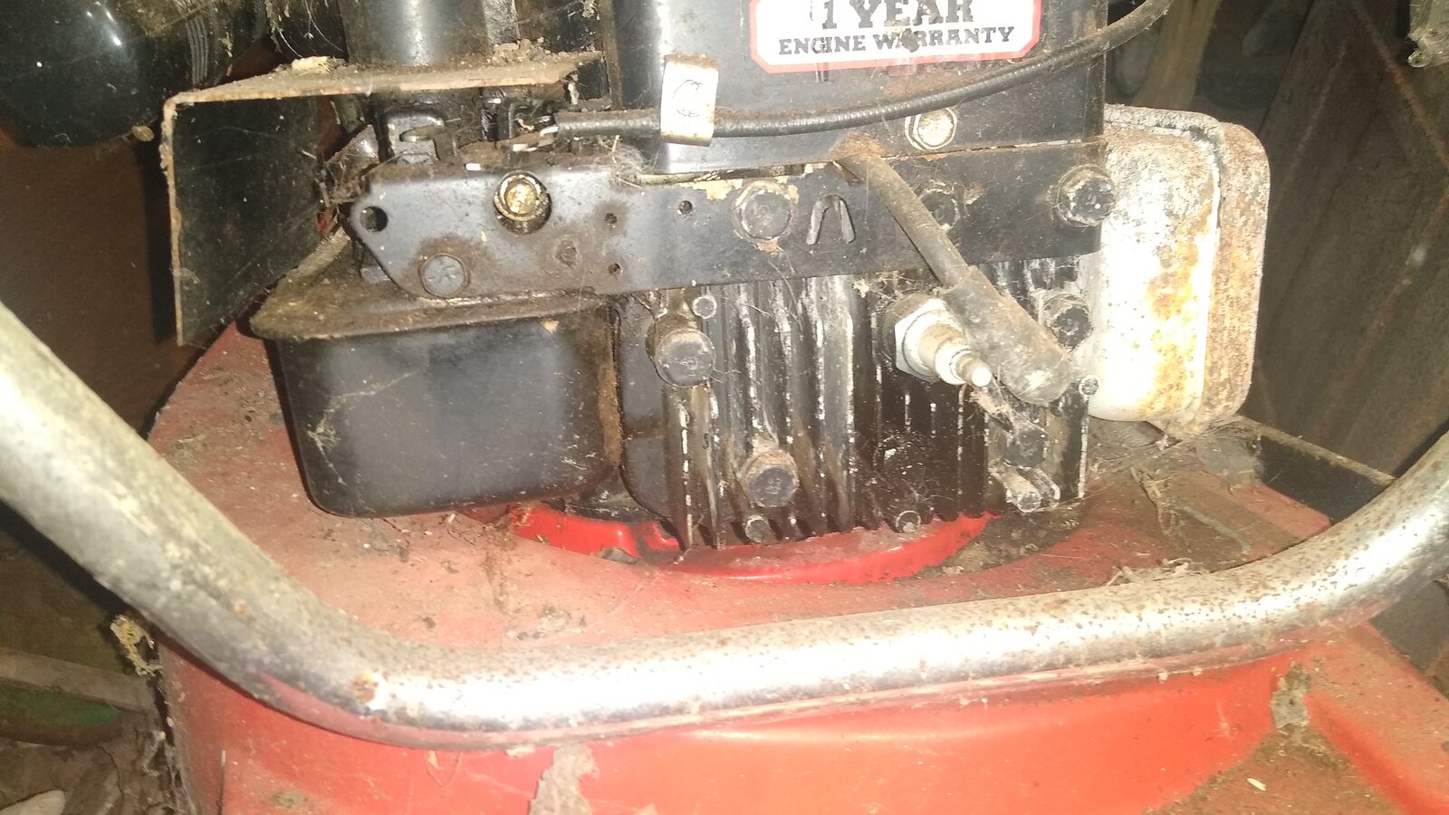

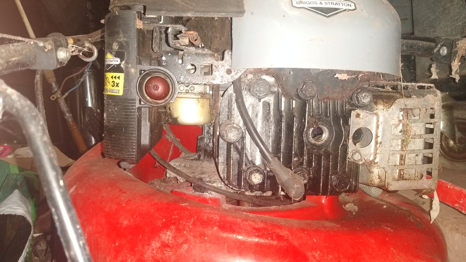

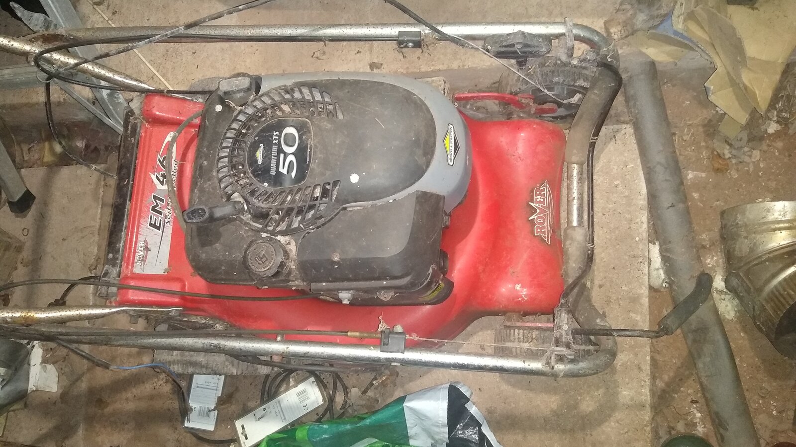

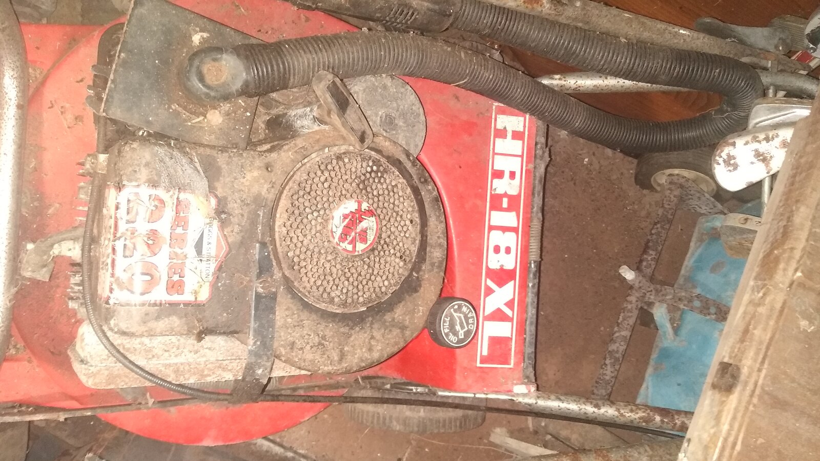

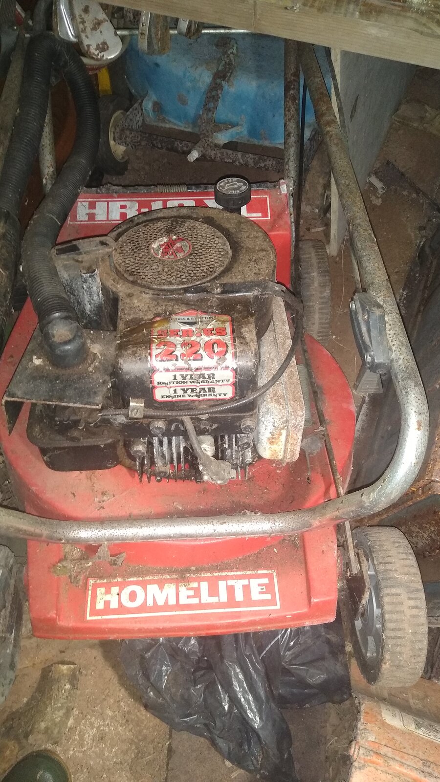

Heres a few pics, perhaps you could do a little research to see if either will fit or you could just take the mowers away and gave a play...the drive is gone in the Rover so beyond economic repair which is why the customer didn't collect. IMG_20230728_192948591.jpgIMG_20230728_192948591.jpg
Hi,
Drive gone as in self propell ?
I think as long as the engine drops in the holes in the deck we should be ok, unless the boss for the blade is different.
The carb cable etc should be able to be got sorted I think.
Yes,self propelled. not sure if the boss is on the shaft as it has a disc with swinging blade so youd have to use your boss id guess. ..I am exactly 12 miles from the bridge so you can work out if its worth your while.
