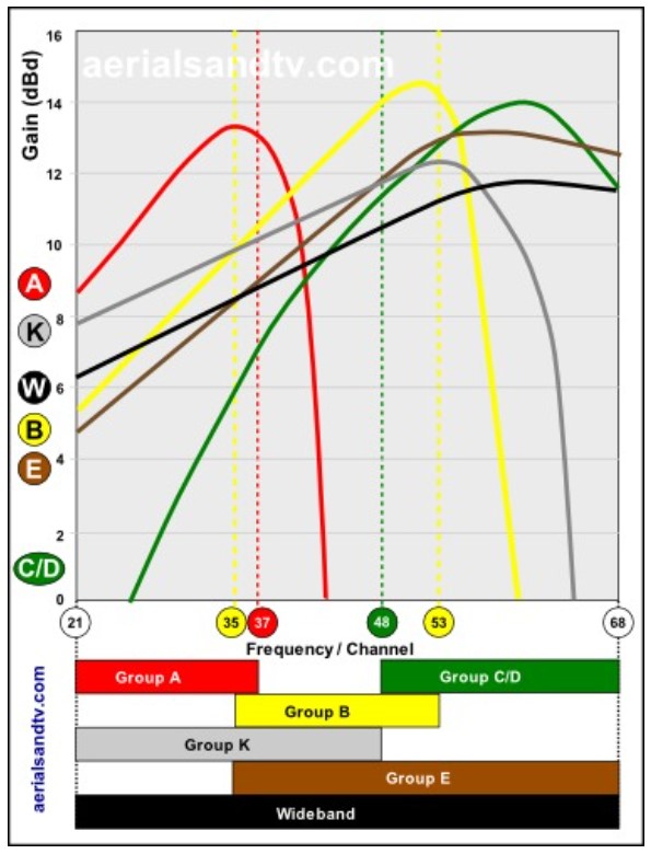

That kind of aerial is known as a tri-boom. They were never great aerials when we had the full tuning range from RF ch21 to 68. Since the 800MHz clearance, and the 700MHz clearance which is still ongoing, the eventual RF channel range will be from 21 to 49. The third or so that's going to be missing (50-68) corresponds to where tri-booms have most of their gain. In other words, where the tri-boom is strongest there will be no TV broadcasts. This is the same for a lot of the older wideband aerials.
Incidentally, the 'black' bit of the description actually means something. Aerials are split in to Groups depending on how much- and what portion of the RF channel range they cover. We used to have Red, Yellow, Green, Brown and Black, with Black as marked by the colour of the end cap covering the whole range but at a lower overall gain compared with those aerials with a more limited range.

Why? It is a T group aerial up to ch60 which is not required now.
It is not as described as it is a 7 element aerial not 32. They have counted the 5 directors 4 times, the dipole twice, and the reflector 10 times.
