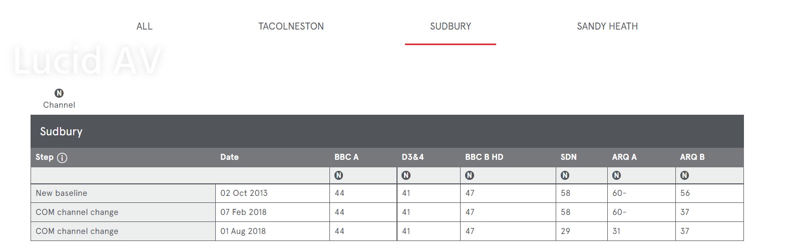

It's a bit curious that you're missing the BBC channels on the medium run cable. According to the Freeview.co.uk signal checker, Sudbury muxes are as follows.

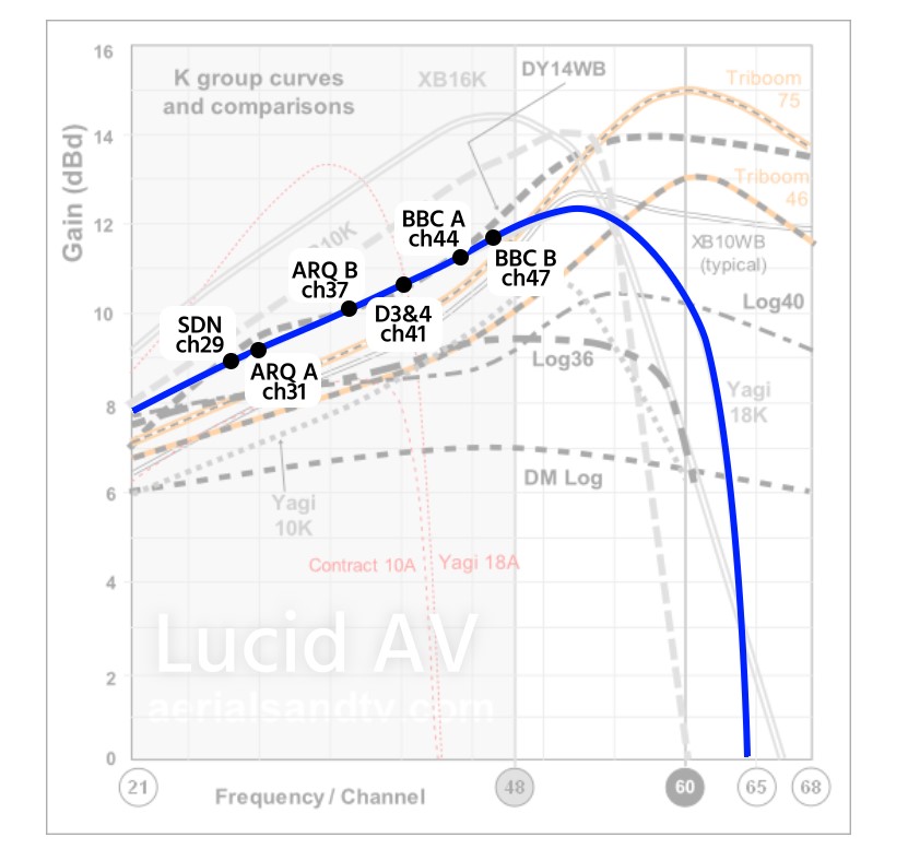

Overlaying that on the Yagi18K curve from the ATV graph, we get this
and it shows BBC A (regional BBC 1 and BBC 2), and BBC B (the BBC HD channels and HD versions of ITV, C4, Ch5 and a couple of entertainment channels) at the highest gain point on the Kagi18K curve. That means as long as the aerial alignment is good then those two muxes get the strongest signals.
If you were going to lose reception on anything then the SDN mux would have been the obvious candidate looking at the gain curve. You might want to recheck the tuning on the medium range TV making sure it's tuned to all the Sudbury mux channels. After that, I wonder if it's worth you just checking the aerial alignment and maybe having a look at the cables and connections down to the medium run TV? A bad connection or a dented cable can create what's known as a notch filter. This means that a very narrow part of the signal range gets weakened enough for the signals to disappear. e.g. BBC A might be lost but BBC B still there.

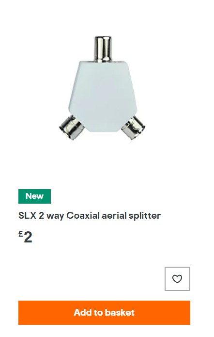

If it's 'i', then the action of splitting will reduce the signal level by 3.5dB or more, but could also let in a dose of noise if the splitter is poorly shielded such as the one in the image below

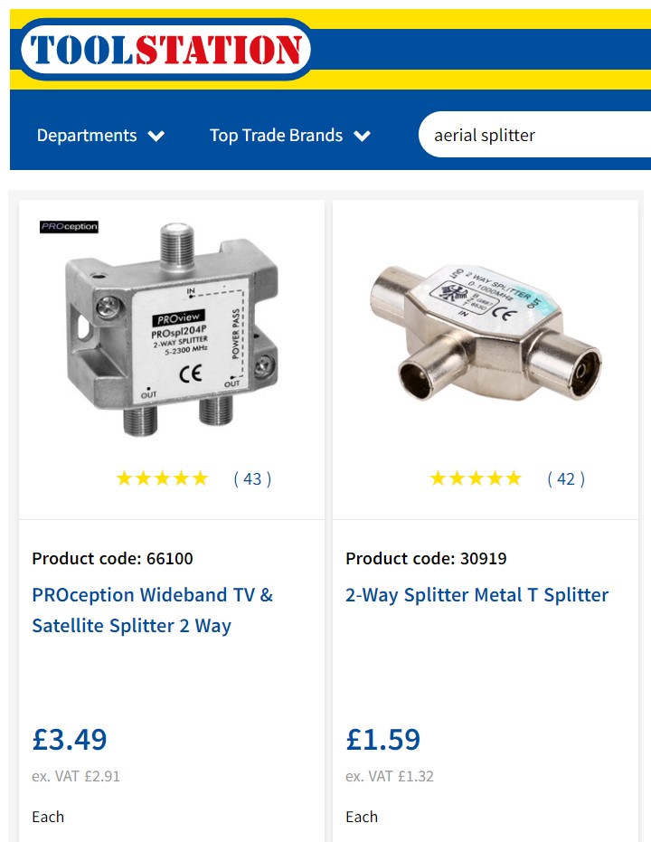

Replace that with one either of these
For TV signals both of these do the same job and to the same quality. The difference other than shape and type of connectors is that the 66100 also works at satellite signal frequencies. You don't need that, but if it's more convenient for you then don't hesitate to buy the 66100.

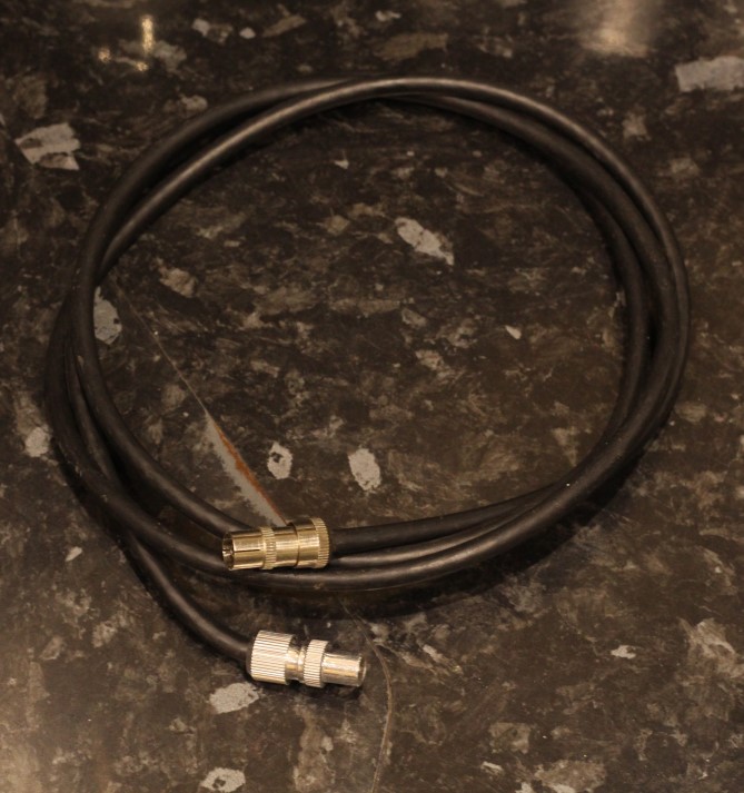

Store-bought fly leads are a common cause of signal issues. They're lossy, and they're poorly shielded, and there's a longer-term issue with their construction which means that the acid in the solder used to join the pin to the centre core eats the connection over time. Since the whole thing is entombed in plastic it's impossible to see and check. A fault might show up if you use a multi-meter on continuity test or Ohms. RF is slightly weird in that a signal will 'jump' a gap or break if the distance is small enough. It's called capacitive coupling. The cable looks like it works with an RF signal but is massively more lossy. To a multi-meter measuring continuity or Ohms then the cable shows up as a break.
The simpler solution is just to replace them, but not with new versions of the same thing.
Short recap... These are crap.

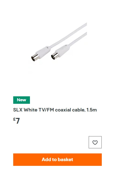

Replace with something like this.
A properly-made fly lead will have decent shielding and the sort of connections that can be checked for issues should the need arise. They're also far less lossy than the bought-in cables, and cheaper too.
You're unlikely to find these read-made in stores and so may need to buy a small reel of cable and some coax plugs to make your own. Where doing so, I'd recommend Webro WF100, Triax TX100, Labgear PF100 or Doncaster CT100 cable. They're all good 100% copper coax cables. Should that prove to be a little OTT for just a couple of short fly leads then I can supply you some made-to-length in either white or black with the appropriate male/female ends to suit your needs.
