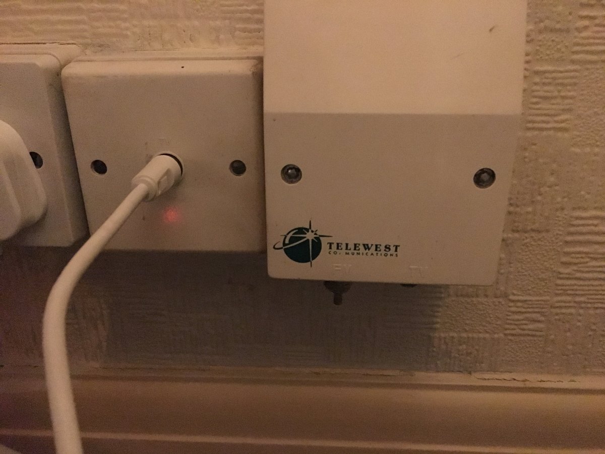

Signal but cannot find the aerial?!
You may well have solved the problem; a quick check on Telewest shows it's a cable provider, so if you take out the screws to the coax box, you may see the cable going into the Telewest box.

Do you think I should see a degredation of the cable signal though? If I stand in the middle of the room it strangely seems to have an effect at blocking the signal? Not that I do this regularly of course but it shows that the signal is not always constant which you would expect from a cable connection?
Plus the front room gets HD channnels and the rear sitting room doesn't get any at all. (Same tv/cables etc)

It appears that there is a straight forward coax box in the front room (on its own) and in the rear room there is a coax box directly next to a telewest cable box with coax coming out of the telewest box into the coax (looks to have been split off). I suspect this is doable?
I just don't understand where the aerial for the single coax box is (as haven't found one) even if the rear room is split from the telewest box.

In the front sitting room there is a 1 gang coaxial socket (on its own) consisting of a brown coax cable with no markings. When a tv is connected to this socket it is capable of recieving good quality signal including HD channels.
In the rear sitting room there is a 1 gang coaxial socket and next to this is a telewest socket as per image. It appears from looking in the coaxial socket that this has possible been split from the telewest box? I believe this as the brown coaxial cable appears to come from the side of this telewest socket. Is this often seen?
Well, it's not a "split" unless two cables are coming out. And you won't receive cable TV programmes without a cable TV decoder. I assume you don't have one and are not paying a subscription, in which case what you are seeing is Freeview programmes possibly picked up by the cable acting as a poor aerial - unless the cable TV network actually broadcasts them for free alongside its encrypted signals.
Correct - no subscription.
Definitely freview channels so I'm assuming as you say that it's being used as a poor aerial.
Thanks for the help
